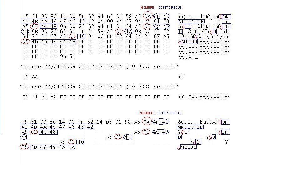

    Here is a second example
    The is OK
    O N M L K J I F E B
    1 2 3 4 5 6 7 8 9 0
    10 BYTES
    A5 0A 4F 4E 4D 4B 4A 49 47 46 45 42
    ¥. O N M L K J I F E B
    2 BYTES
    A5 02 4C 48
    ¥. L H
    3 BYTES
    ¥. L H D
    A5 03 4C 48 44
    1 OCTET
    A5 01 4A
    ¥. J
    5 BYTES
    ¥. M I I J J

    This is an electronic circuit of a base pic 16F876 and I looking for information
    and understand how to have protected EEPROM?
    is it possible to protect against the reading for the pics?
    this example and decryption I put on the site is to give an idea.

    At the first start-up, you generate a table of random byte in Flash. And you do a XOR between the data write (read) and the table. You can complicate making an XOR between the EEPROM and the address table
