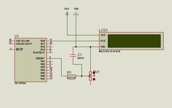

One of the labs from "What's a Microcontroller?" is to read the value of a potentiomemter. So I made the exact same schematic from the Basic Stamp book but using my PIC16F84A. (Attached is an image showing my electronics.)
Than I used the following source code. Problem is the only value that ever gets stored in the variable "time" is the state I specify on the command line. Could anyone point me in the correct direction to properly reading the value of a pot with PICBasic Pro?
