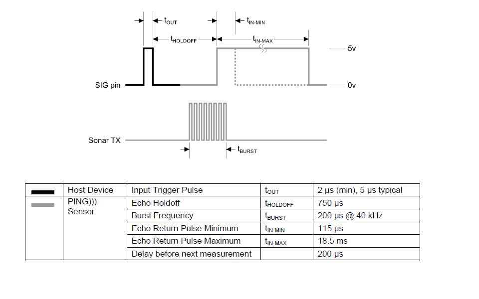

    Hello. I am trying to use Parallax ultrasonic Sensor PN 28015
    For some reason, I cannot get the code to work. I have searched for quite a bit and found examples of people using similar code with the same and similar(devantech sf04) devices.
    I am using a PIC16f887 at 8mhz external oscillator. This should give a pulsout cycle of 5us.
    In the attached image you can see the interface info for the sonar sensor. It appears that I send a pulse of 5us, wait ~750us then read back a result upto 18.5ms. Any idea if my current code fulfills these goals?
    I have hooked the devices upto an o-scope and verified their operation. I can see the return pulse begin 750us after the end of a trigger pulse. I read in the pic basic docs that the pulsin waits 65555 cycles for a pulse to time. Is this all working with my current code?
    When I trigger the device, the sensors LED lights, but I always get back a 0.
    Here is my code.

    You are not waiting 750uS between sending the pulse and measuring the return pulse - if that's what you're trying to do. It may be a case of read-modify-write where the output doesn't actually have time to return to LOW between the PulsOut and PulsIn command and therefor the PulsIn command misses the return pulse - just an idea.
    If you know that it will be at least 750uS between the end of the outgoing pulse and the beginning of the return pulse then try inserting a PauseUs 700 or something between the PulsOut and PulsIn commands.

    Henrik,
    TRISB.0 = 0                 ' setup port b.0 as output initially
    ANSEL = 0                   ' disable all AD convertors
    ANSELH = 0                 ' Disable PortB AD
    Thanks for the reply. I fixed the problem. So simple - configuration fuses. On the Pic16f887 there are 12 A/D ports, spanning port A and port B. Apparently PortB.0 defaulted to analog in. It magically worked when I properly configured it! So much troubleshooting for one little fuse.
    Incidently, I tried the pauseUS method you recommended, it didnt help - probably because the pin was setup as an analog convertor.
    The code worked without a pause once i configured the chip correctly.
