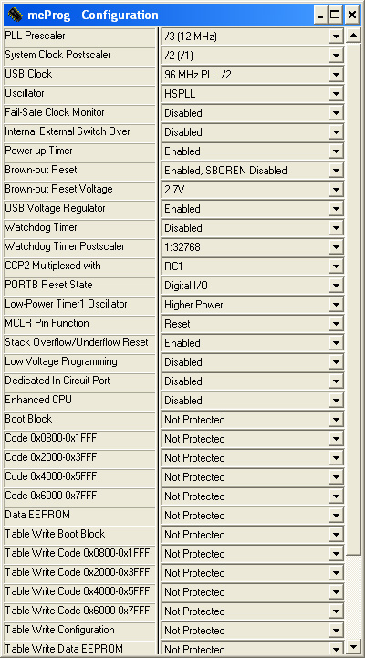

The configs look OK.
The PORTB.0 read looks OK.
