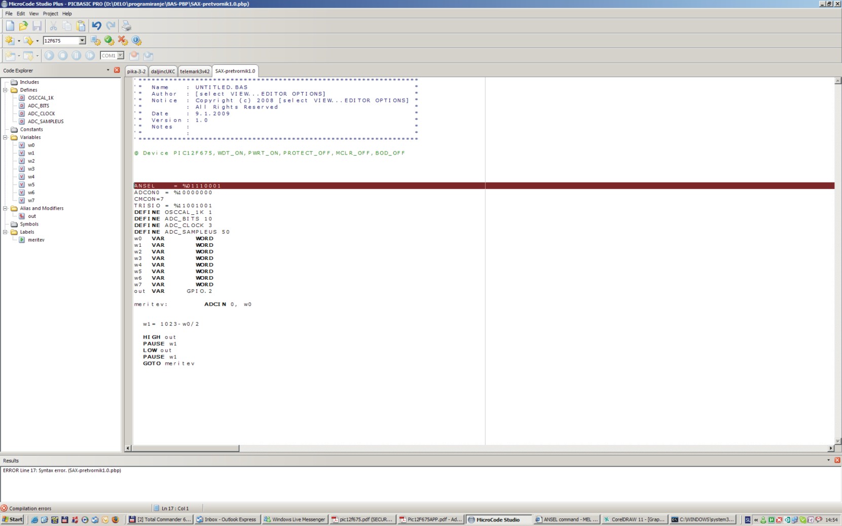

    I was made one simple test program with ADC. I have problem with MCS compiled. I don't understand what is wrong with ANSEL = 1 command? Into status line write syntax error!! When disable this ANSEL command compiled finished ok. I was trying compile with PBP2.50b and MPASM and result is equal.
    Who is problem here?
    @ Device PIC12F675,WDT_ON,PWRT_ON,PROTECT_OFF,MCLR_OFF,BOD_ OFF
    ANSEL = 1
    ADCON0 = 3
    CMCON = 7
    DEFINE OSCALL_2K 1
    DEFINE ADC_BITS 10
    DEFINE ADC_CLOCK 3
    DEFINE ADC_SAMPLEUS 50
    w0 VAR WORD
    w1 VAR WORD
    w2 VAR WORD
    w3 VAR WORD
    w4 VAR WORD
    w5 VAR WORD
    w6 VAR WORD
    w7 VAR WORD
    out VAR GPIO.2
    meritev: ADCIN 0, w0
    w1= 1023-w0/2
    high out
    pause w1
    low out
    pause w1
    goto meritev

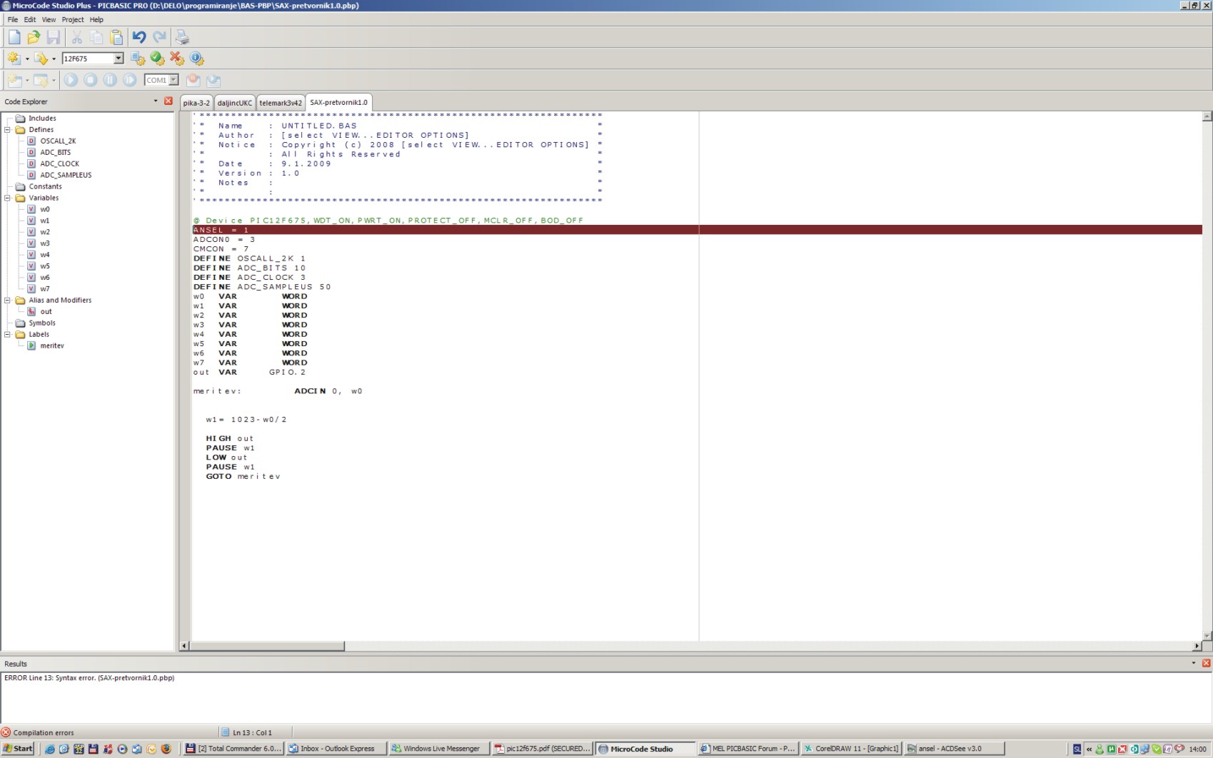

    I was repair our routine and result is no unchanged. Here must be another problem
    show attachment
    Wink
    I do not think this:
    exist with PBP, PM, MPASM, nor MCS ...
    last effort ... go on !!!
