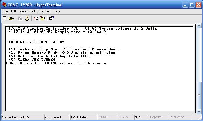

    I've run the routine you supplied, well ... had to add some stuff cause it was just a snippet, and my crystal was different.
    It ended up looking like this ...

    And here is what it displayed ...
    <img src="http://www.picbasic.co.uk/forum/attachment.php?attachmentid=3092" /><!-- Name:  Menu.gif
Size:  15.8 KB -->
    The problem doesn't seem to be in that routine.
    Maybe somewhere else in the code?
    Need more Input.

    Default Thanks Darrel
    Darrel, Thats exactly as it's supposed to look. Thank you for verifying the code. I wonder if you hit 'C' and clear the screen a bunch of times does it screw up the display for you?
    I will keep searching. That routine is was screws up on my end. if I try adding menu items (7) and (8) ect it really messes up.

    Quote Originally Posted by jamied View Post
    The location MENU: (result of "C" PCCommand = 67) wasn't included in the snippet.
    Can I assume it's the routine shown?
    Happy to test any portions provided.
