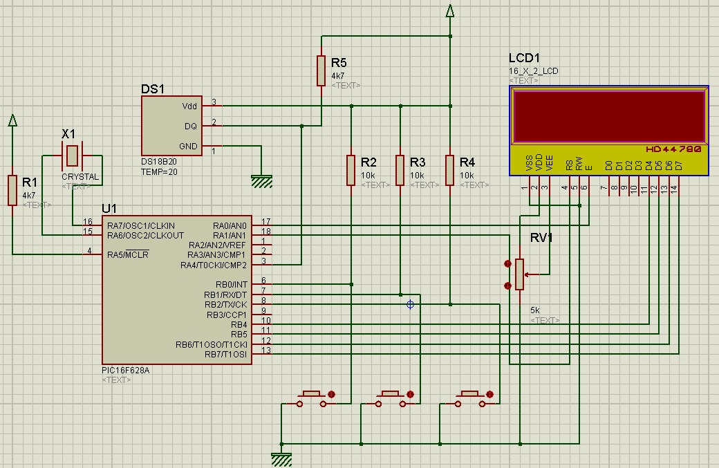

    The software it's ok !!! Remove the X-tal (leave pins 15 & 16 free), re-compile the code with added from post #73, check the RV1, check the connection to LCD., check the voltage (5 volts).
