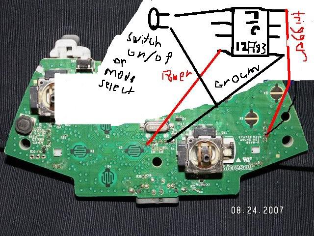

    exept there rapidfire is on the acuall triggers and when the triggers are beig pulled it reads the low or high (depending on your controller model) than sends the low pulses for rapidfire
    But before the rapidfire on triggers i wanted to get it to work on external buttons so look down =]
    I recently made a attemp on 12f683 to not use the triggers but a external button and this is my code And when I tested it it didint really work. its a 2 mode rapidfire the first mode is fully rapidfire and when you press the button it goes in mod 2 which is a 3 round burst all i want it to do is pulse first in loop 1 then if a nutton is button is pressed which is hooke dto ground it will go into loop2 to fire in burst and i need your help guys...

    No Problem ! Everyone's just too serious, I will be glad when 12/26 rolls about ! Anyway we'll whip up some tasty spaghetti, unless we get some experts to help, long as it works Hey!
    I've been working on an NKK display in another thread for what seems like a week (3 days). So I hadn't been paying much attention to this one.
    After a quick review, the problem I see is that there are a lot of buttons on the 360 controller. It's most likely that the buttons are "Multiplexed".
    In the PDF of the original project, it shows an input FROM the button, and an output TO the button. So apparently the pulses can only be put out when that button gets scanned.
    This will be more difficult than just toggling a pin 3 times.
    Do you have an oscillicope to verify if they're scanned or not?

    well those are not buttons the middle one is the one that acually bings the low to fire the trigger the others are inputs and outputs dont know whih ones ill do some more research thanks!

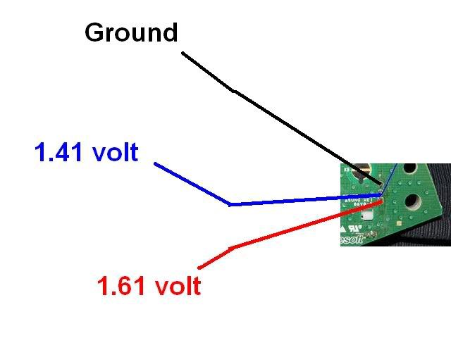

    Hey after playing around and some testing with my new multimeter I found out this, The top pin is always low or ground the middle pin is 1.41 volt When the trigger is not held down, But when you start pressing the trigger it slowly starts decreasing, the more you hold it down the less the voltage gets. When i held the trigger down all the way It was at 0.31-0.30 volts thats afcourse when its down all the the way but even if you press it a little bit the voltage will decrease a little bit and the bottem pin of the 3 is at 1.61 volt all the time and doesent decrease nor increase. This is afcourse on this version of the controller while the other fires off high but not low like this
