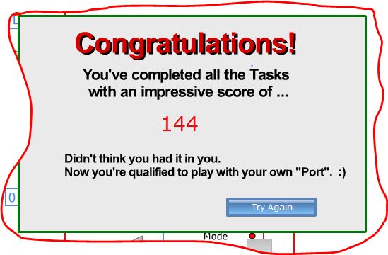

    Do I get a prize or something?
    -Bruce
    tech at rentron.com
    http://www.rentron.com
    Hmmm, I guess being qualified to play with your own "PORT" isn't worth much when you're married.
    144 That's "Gross".
    Actually, I don't think I ever got higher than that either.
    And I knew the questions ...
