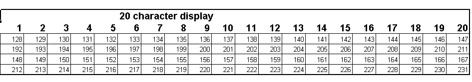

    Here is a Map of the LCD Display giving the address of each cell. simply do as the book says and use that address where you want the first character to appear.
    example:
    LCDOUT $fe, 128, "this example uses "
    LCDOUT $FE,192,"the first 2 lines"
    see the numbers 128, 192, find them on the chart.
    It makes no difference if you use decimal or hex representations. 128 = $80, $FE = 254
    LCDOUT 254,1 will clear all characters from the screen.
