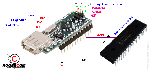

    hi
    can any one post circuit diagram to connect VDIP to PIC ??
  18. #218
    Nov 2009
    72
    Default Re: USB to USB flash Drive File Copier
    read the comments in this thread. and download pdf files from http://www.ftdichip.com/index.html to gain more knowledge about the vdip...goodluck.

  19. #219
    Nov 2009
    72
    sorry about that., this is a better picture

  22. #222
    Sep 2011
    2
    Newbie, what is the easiest mode in interfacing the VDIP1 Module and PIC microcontroller,,, UART or SPI?
    I have seen in this site(http://www.pic_examples.byethost3.com/VDIP.html) that he used SPI mode in interfacing the PIC and VDIP2 module...
    But, I'm planning to buy VDIP1 because it is more cheaper than VDIP2 module.
    Do you have any circuit diagram just like in that site using UART mode in interfacing the PIC and the VDIP1 module not the PIC and VDIP2 module???
  23. #223
    I think the easiest way to get started with this device is to follow this
    http://www.picbasic.co.uk/forum/showthread.php?t=7700
