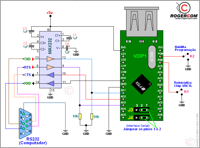

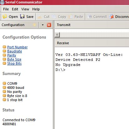

    We need to get your VDIP working at 4800, 8, N, 1.
    The zip file attached has FTRFB.FTD in it. Unzip the zip and put the FTD file on a blank USB stick. The VDIP should see this file and do a firm ware upgrade. You do not need to send any commands at this point.
    I have the VDIP1 connected to a terminal to see what is going on.
    VDIP connections:
    PIN1 = 5VOLT
    PIN6 = PIN11 on a MAX232 PIN14 on the MAX goes to PC serial PIN2
    PIN7, 10, and 18 = GROUND (ZERO VOLTS)
    You can take PIN22 LOW to reset the VDIP1
    A screen shot of the VDIP running at 9800 changing to 4800.
    And a screen shot of the VDIP running at 4800 rebooted to the same USB stick.
    I will try to get more time later this weekend to play some more.

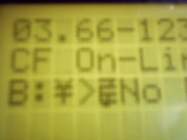

    does the serial communicator automatically change the firmware at the start of the connection? no need to enter any commands?
  10. #90
    To upgrade the firmware you do not need to send any commands. If the VDIP sees a new firmware it will upgrade to it. When a new firmware is "built" a three character ID is given to it. The ID is whar the VDIP looks at.
    The firmware I gave you has NE1 as the ID. If the ID is the same the VDIP will return "No Upgrade".
    Go down to post #19 here.
    http://www.picbasic.co.uk/forum/show...3888#post83888
  11. #91
    Nov 2009
    72

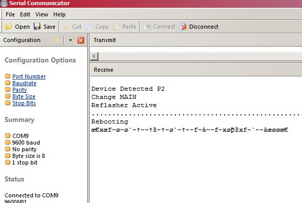

    I use the hyper terminal for serially communicating the vdip to the rs232. ive attached the level converter circuit that i used here in this post. you might as well take a look at it and see if it differs from the one that you know. that circuit worked very well when i used the hyper terminal but when I tried to use the microcode's serial communicator, it didn't respond to anything that i did. i reconfigured the circuit according to you pin assignments but the results were the same. does this have anything to do with me using vdip2 and you using vdip1? but then im pretty sure that i carefully reassigned the pins in the vdip2 that are equivalent to the vdip1.
    since microcode's serial communicator does not work for me, i switched back to hyper terminal but when i inserted the flash disk with the new firmware in it(with a different 3 letter ID), it did not detect any upgrade. so i was forced to use the command used for upgrading the firmware. I typed in FWU FTRFB.FTD. after that it prompted:
    ChangeMAINTD
    Reflasher Active
    Rebooting
    for a moment i look like the one in your printscreen but then after a few seconds it displayed the previous firmware with the previous firmware ID and the vdip2 was still working at 9600 baud rate. Ive also attached the printscreen of that event in this post. you may see it for yourself.
    what can you say? should i stop trying to change the vdip2's baud rate and make the pic micro controller adapt to it instead?
  12. #92
    I this point I would say yes, run at 9600. I do not have a VDIP2 to test so I am at a loss.

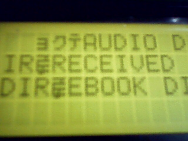

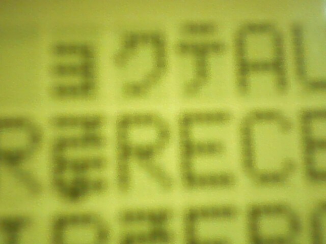

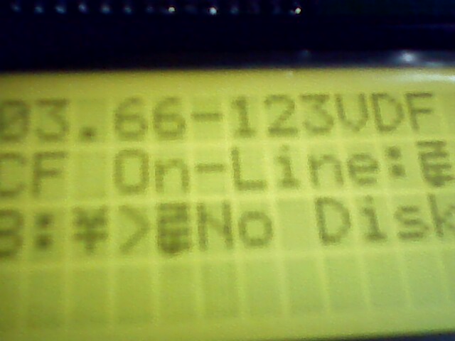

  25. #105

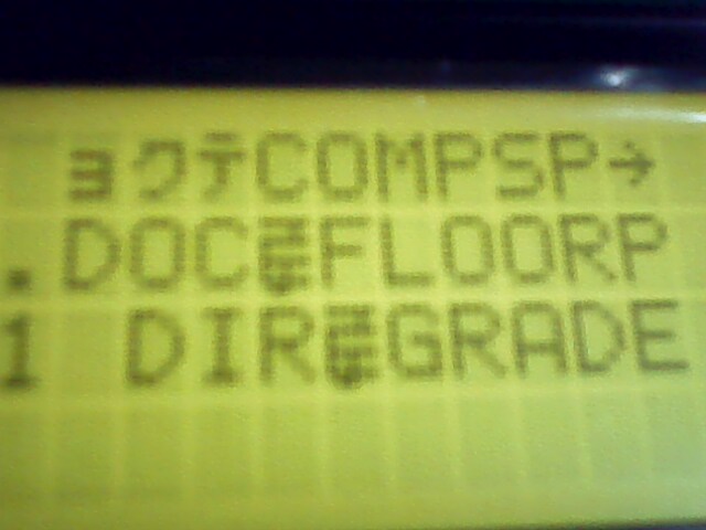

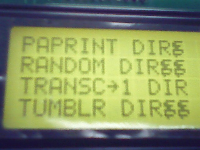

    Nov 2009
    72
    finally something good happend...
    i can already print the file names inside the flash drive to the LCD
    the cause of why i could not print anything earlier was maybe because of the timing of the execution of the command. there where probably times when the vdip was already sending data to the pic but the pic was still busy of doing another thing like printing welcome notes to the lcd (or something like that..) so the data could not the printed to the the lcd.so what i can is, the PAUSE command plays a major role.
    as for the printing of the file names, im having trouble arranging the files line by line to the lcd..primarily because they do vary in length and also other weird characters come in between some of the words which i guess are due to the line feed or carriage return..
    does anyone have any idea of how i can save a string into a different variable each time a line feed of carriage return is encountered?

  30. #110
    Nov 2009
    72
    hi! here's what has happening to my project so far... ive been interfacing a vdip2, a pic16f877a and a 4x20LCD. i can already print the responses of the vdip to the LCD..but my problem is that some characters appear in between the file names which do not appear when the vdip is connect to the pc. ive searched the ascii tables http://www.ascii-code.com/ to see if these characters have an equivalent hex code so that i can use it for the wait() command in picbasic pro..but i did not find the characters in the table. i first thought that it was a line feed but when i used the code $0A(line feed) for the serial wait() command, it did not work... do you have any idea on these characters are? ive attached some images, you might want to take a look on what these characters look like...Name:  IMG0273A.jpg
  31. #111
    Looks like you about have it!!! Good job!!!
    Look at the data sheet for the display and there should be a "Character Font Table". Those characters show up there.
    Why the commands are being sent to your display and how to fix it I do not know...
    Thinking....
  32. #112

  35. #115
    About a year ago I had the bright idea of using a PIC and a VDIP1 to transfer file to a Burny 2.5 CNC controller. I could never get it working properly and gave up.
    The Burny was never happy with the data being sent to it. My simulation software worked fine. I wonder if what newbie is seeing was the problem with the Burny?
    Somehow the VDIP is sending "ghost" info??
  36. #116
    Nov 2009
    72
    hi guys thanks for the replies but i think i got it...
    the weird characters were carriage returns ($0d).
    i used this code..
    CRET VAR BYTE
    CRET = $0D
    SERIN2 VinTXD,84,[WAIT(CRET),STR FILE1\12 \CRET,WAIT(CRET), STR FILE2\12 \CRET,WAIT(CRET),STR FILE3\12 \CRET,WAIT(CRET),STR FILE4\12 \CRET]
    as you can see i waited for every occurrence of the carriage return and saved the characters found between them into an array of string.
    the weird characters that you can see at the end of some files names in the lcd are i think blank or null arrays since i allocated 12 array places for every file name found but not all of them would be 12 characters long..some are less.
    now could you suggest any better way of storing these file names?
    because i think if i do it this way, my pic microcontroller would quickly run out of space to save all of the characters from the file names and if the flash drive inserted is very populated then the files names not saved in the array would not be displayed.
