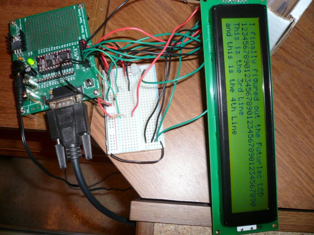

    Default Futurlec LCD working now
    I managed to get the Futurlec 4 x 40 LCD working. In my case, I did this with a BASIC Stamp. I hope I'm not escorted to the door from this forum. I found this forum to find a solution for communicating with an LCD. See attached photo.
    Bill's initial thread actually had the correct pin assignments that were the key to getting me started, although the Futurlec LCD has no pins 17 & 18. Internet research had consistent documentation on 4 x 40 LCD with two rows of pins having different assignments than those posted on Futurlec's site. Those are clearly WRONG! Also, A and K connections are for the back light and are straightforward.
    The second challenge was understanding how to address the 3rd and 4th lines on the display. My experience with LCD displays was limited to 2 x 16 and 4 x 20 serial units that have an entirely different way to address the screen coordinates. The 3rd and 4th lines are addressed with the second enable pin. This forum clued me in on that .. thank you. So I had to initialize both controllers in the LCD and communicate with the device as basically a stack of two 2 x 40 LCDs in one unit. The LCDCMD command in PBASIC allows me to address a set of pins in 4 bit mode while allowing some flexibility on which pin is the enable pin. This permitted me to address both sets of lines by adding the one additional connection to the LCD for the extra enable connection.
    I am not versed on PIC language, but I'm sure it's doable if I've done it with the BASIC Stamp.... code attached.
    Rick

    Rixter,
    Thanks for your message and I'm pleased to learn that the pin-outs in the first post are correct. I must have made some wiring error because they would not work for me? I will have another go.
    I have, since then, got some different 4X40 LCDs, with correct tech details, and they work well using the method posted by RHINO - a couple of resistors on the two ENABLE pins and a bit of code.
    One mistake that took me a long time to find was using the PBP command "CLEAR" after the definition on the LCD1-Enable and LCD2-Enable pins - the CLEAR command clears the definition:
    Murali,
    If you are not able to locate the datasheet, what information are you seeking for this LCD? I have successfully attached this LCD to a processor as I explained in an earlier thread on this post. I have gotten another LCD from this company and it is yet a different LCD than the one I received the first time and different than the datasheet. Their information is not correct for the model mentioned in Bill's post or the second one I received.
    I found other similar pin diagrams for 4x40 LCDs that did the trick for me. The key lays not only in knowing which pins are for what, but also understanding that these units have two controllers.... one for the top two lines and the other for the bottom two lines. Pins 1-8 are for data (DB7 down to DB0 respectively). In my case I only use 1-4 because I am using 4 bit mode. Pin 9 is the enable for controller #1, Pin 10 is RW, Pin 11 is RS, Pin 12 is Contrast, Pin 13 is Ground (VSS), Pin 14 is VDD, Pin 15 is enable for controller #2 and Pin 16 is no connection. Pins A & K over at the opposite end are for the LED backlight..... A being positive and K being negative.
    So to write to lines 1 or 2 on the LCD, you must enable at Pin 9 before your write and to write to lines 3 and 4, you must enable Pin 15 before a write. In the case of BASIC Stamp that I am using, I just specify a different parameter in the LCDOUT command to activate the other enable pin in my outputs to the LCD. The concept should apply in your implementation as well.
    Anything I can do to help out, just ask.
    Rick
    Nov 2007
    South-West of Australia. A small town called Denmark. 'Where the forest meets the sea.'
    136
    Default Futurlec 4X40
    Murali,
    1. The pin-out on the Futurlec site is wrong - a 4X40 MUST have two ENABLE pins.
    2. Rixter says he has got the device working using the pin-outs on my first post of this thread. They didn't work for me but I may have made some wiring/software error. These are the revised pin-outs sent to me by Futurlec.
    3. Take up his offer of assistance - after months of messing around with 4X40 LCDs I am starting to think they are not worth the trouble.
    4. It's quite irritating that Futurlec can not be bothered to put up the correct data on the web. I know their prices are rock bottom and they need to keeep costs down but it's only a few minutes of work?
    Regards Bill Legge
    Apr 2009
    3
    Dear Rixter & Legge,
    Thanks for your prompt reply. Now my display is working for the first two lines or the second two lines. I am trying to complete the same
    Rgds
    Murali
    4
    Murali,
    I am guessing that what you are saying is that you can get either the first two lines or second two lines to work, but NOT both at the same time.
    I'd say if you are getting all four lines to get something that you are well on your way to success and you have some minor code issues to check.
    You could have a couple of things going on there. You may be putting the LCD into a condition where the unit is resetting (initializing), as you do each write cycle. Or you could be doing a screen clear of the opposite set of lines that you are displaying. For example, you might be clearing lines 3 & 4 as you write to 1 & 2 and clearing 1 & 2 as you write to 3 & 4.
    My code would be different than what you would use because I am using a BASIC Stamp, but the logic should be the same. In my case, I am clearing lines 1 & 2, then writing to lines 1 & 2. Then I clear lines 3 & 4 before writing to lines 3 & 4.
    Rick
