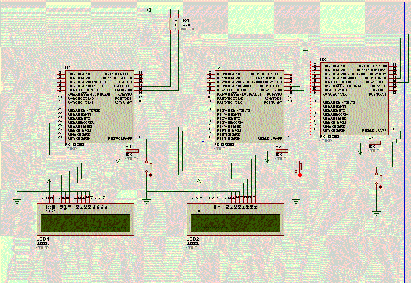

    Hi, I'm interested to try the master-slave(I2C) worked by Daniel and other members, sorry if it is not obvious for me in the code given, but can someone share the schematic used in the example?
    I'm using Pic16877(master) and Pic16F88(salve).

    From the code provided, here is how I interpret the pin connection between pics.
    Master(Pic16F877A) Slave(Pic16F88)
    (SCL)RB5 <---> RB4
    (SDA)RB7 <---> RB1
    but with this connection, LCD displays "Time out", can anyone help me what I'm missing?

    Did you pullup SCL and SDA with a 3.3K resistor?

    Thanks for replying, I added the resistors but I have the same output("Time out" on the lcd). Any idea what causing the issue?
    Thanks in advance,
    tacbanon
    Attachment 6422

    You should post the schematic of your setup along with the code you are using. Without more info it is difficult to give you proper answers.
    Al.

    Hi again,
    Here is the code I'm using..

    The codes I'm using is from Daniel(copy and paste).
    BTW I'm using a simulator...

    Very likely is a simulator problem!

    Okay, I will try it in the real hardware(need first to buy Pic16F88), and post here the result. Can anybody in the forum who has Proteus to try to test if similar output I'm having?

    While waiting for my Pic16F88(probable by next week) I tried to play with this code below with success in the simulation...

    As I understood, in the master pic the code below tries to communicate to the Slave having the address $02
    i2c_address=$02
    I2CREAD sda,scl,i2c_address,[STR i2c_data\6]
    LCDOUT $FE,$80,DEC i2c_data[0]
    LCDOUT " ",    DEC i2c_data[1]
    LCDOUT " ",    DEC i2c_data[2]
    LCDOUT " ",    DEC i2c_data[3]
    LCDOUT " ",    DEC i2c_data[4]
    LCDOUT " ",    DEC i2c_data[5]
    and display data from Slave to the Master pic LCD. Then I tried to modify the setup and add another Slave#2 with address $0B like the this code below..
    i2c_address=$02
    PAUSE 1000
    LCDOUT 254,1
    i2c_address=$0B
    PAUSE 1000
    GOTO main
    What I get is "6 5 4 3 2 1" and "0 0 0 0 0 0 " should be "1 2 3 4 5 6" for Slave#2

    I was only hoping that it would work that way(I guess not ), how can I add another Slave and get data from it? I appreciate any help and the time for sharing.
    Thanks in advance,
    tacbanon

  13. #93
    Default Re: Please help me understand how the application works
    In your previous code with the F88, 3 is not a valid I2C address.
    In the current code, $B is not a valid I2C address.
    They should be a multiple of 2.
    Bit 0 is reserved for the R/W bit.

    Hi Darrel,
    Thanks for replying, I did some testing on 1Master and 1Slave with these address($02,$04,$06,$08,$10,$12,$14) and works fine. But when I trying to add Slave #2 I get "0 0 0 0 0 0". It only reads on the Slave #1 correct (displays "1 2 3 4 5 6").
    This is how I code to read the 2nd Slave.

    BTW the code for Slave1 and Slave2 are identical (Slave#1 is address $10 and Slave#2 is address $14)
    What I'm doing wrong in the code? I appreciate very much your help.
    Tacbanon
  15. #95
    If you comment out the first I2CREAD, is it able to read from the second slave?
    If you change the order so that it reads the second slave first, is it then unable to read the first slave?
  16. #96
    Jun 2011
    Philippines
    223
    Yes it is able to read.
    Nope, displays "0 0 0 0 0 0" for first Slave, 2nd Slave shows "6 5 4 3 2 1"
  17. #97
    It sounds like a buffer overflow.
    ... bad comment deleted ... duh!!
    If you post or email your .DSN, I'll take a closer look.

    Thanks for the files tacbanon.
    Well, this code for the slaves will allow it to read from both devices.
        IF SSPCON1.6 THEN SSPCON1.6 = 0
    i2c_int_handler:
        IF i2c_read then
            IF i2c_buffer_full=0 THEN
                SSPBUF=i2c_data[i2c_data_index]
                i2c_data_index=i2c_data_index+1
                dummy = SSPBUF
            i2c_data_index=0
        i2c_release_scl=1
    @ INT_RETURN
    But it's still not right. And is not a complete slave.
    According to AN734 there are 5 states to maintain. 6 including the ERROR state.
    Your original code only handles 1 state, and this modification only does 2 states.
    I think by adding the other 4 states, it will get rid of the buffer overflows, but I'm not absolutely sure.
    I'm going to convert AN734 state machine to PBP and see what happens.
    May take me awhile.

    Sorry I was not able to make it work on my setup..I'm not really sure what the following code is doing, so I tried to comment it and assign a value, but no effect.
    I2CMajorAddress     CON $3
    I2CDeviceAddress =  $8
    'I2CAddress = (I2CMajorAddress <<4) | I2CDeviceAddress
    I2CAddress =$14
    I hope it will be alright if you share the master side code?

  29. #109
    Default Re: I2C Salve with a PIC
    At this point, I'm thinking Al (aratti) was right.
    AN734 didn't work either.
    Bytes are being put in the SSPBUF without an address match.
    So the slaves that aren't being accessed are overflowing during reads from other devices.
    The code I gave earlier works because it's resetting the overflow in the main loop, but that's just not right.
    I'm trying to get some more info from Labcenter.

  32. #112
    tacbannon,
    The problem with Proteus and multiple I2C slaves has been fixed by Labcenter.
    If you update Proteus to 7.10 SP1, you should have better luck.
