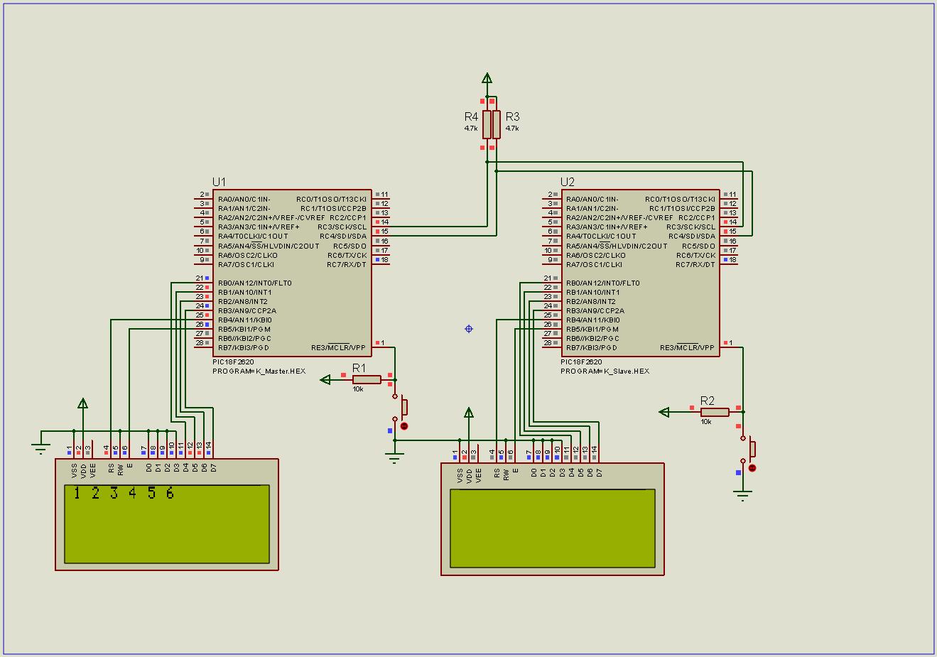

    Hi all. I need to synchronise an array from one PIC to another (one way only), so I have been working to make a simplified version of the code seen in this thread with just the bare essentials to send the array from slave to master.
    It mostly works, but there is one little bug. I am sending the array over and over again - the test array is 6 bytes and I have assigned test values of 1 2 3 4 5 and 6.
    On the 1st i2cread the master receives 123456. On the 2nd i2cread it gets 234561, and the third 345612. It seems that every time I do an i2cread, the following byte goes missing. The first time I get 123456, the next 1 goes into oblivion and therefore the next packet is 234561.
    I know I can get around this by sending a dummy byte after the array, knowing that it will be lost, but I'd like to know why this is happening if anyone has any ideas?
    Master PIC (18F2620, 40Mhz HSPLL):
    DEFINE OSC 40

    I didn't see a problem from just looking at the code, so I ran it in the simulator.
    And I don't see a problem there either.
    On the master I get " 1 2 3 4 5 6".
    It does not change.
    I only added a toggle in the Master's main loop to verify it was looping.
    And a toggle in the Slave's handler, to verify the transfers.
    Is there something you stripped out before posting that could have caused it?

    Thanks for looking DT. I'm currently running the above code "as is" on 2 breadboards side by side.
    Still losing a byte every time I do an i2cread.
    I tried reading one byte at a time instead of six, and I get: 1, 3, 5, 1, 3, 5. So no matter how many bytes I receive at once, it always skips the byte immediately proceeding those bytes.
    *edit* My circuit is identical to yours there DT except for 10mhz crystals + caps, and I only have an LCD on the master PIC.
