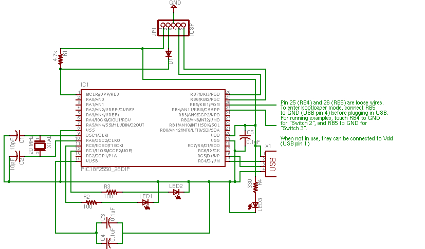

    One further equiry
    would the following schematic work for the usb cdc or is there anywhere i can go to find a better schematic.
    Not sure of the ICSP header, which seems odd, but overall it seems good enough.
    Nov 2008
    12
    Great
    Compiled everything and all seems great, loaded the code into the PIC, plugged in the usb cable into the PC and nothing!
    Why? i have the power LED come on, not sure if the diagnostic LED's are meant to be working, but they are definately dead! This stuff drives me insane!
    If you have a 20MHz, and sure of your connection, it should work, or at least tell you something!?!
