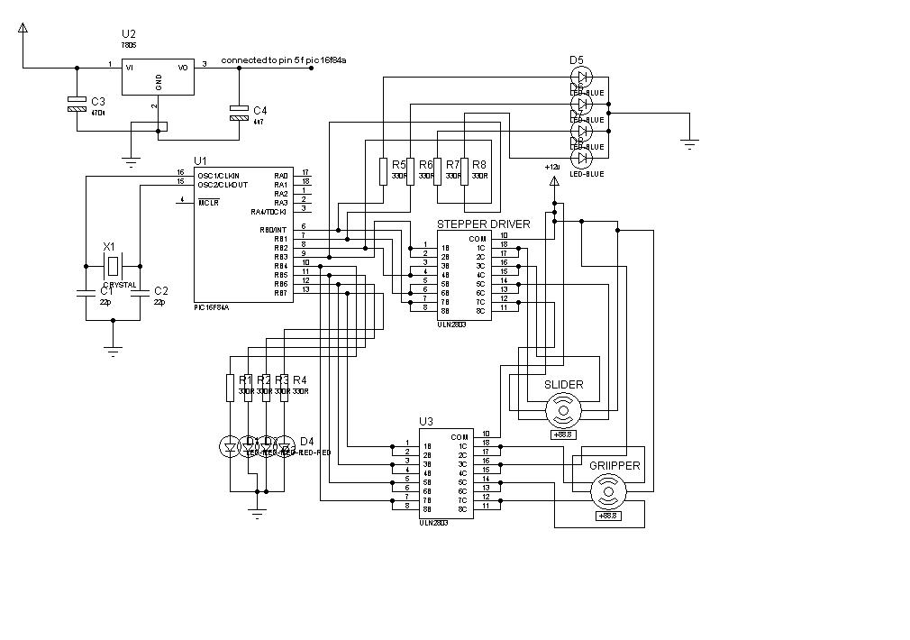

    the schematic above is the one i used to...
    i am using pic16f84 and uln2803...

    From the schematic you have posted, you have left the MCLR pin floating, and this is the reason of the problem you reported. Connect the MCLR pin to Vdd (+5V) using a 10K resistor. If you need to reset your chip then short the MCLR pin momentarely to ground for a second and than remove the short.
    Did you connect ULN2803 to ground ?
    Al.
