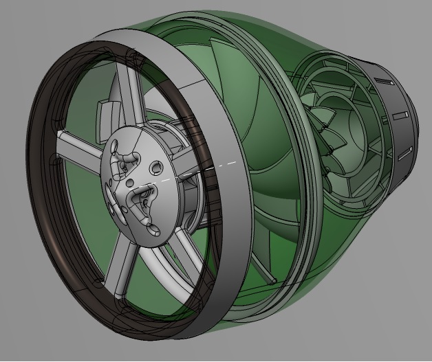

    normally i dont open a new thread, i really dont like it, so i will continue the next request from you guys here.
    If any moderator would like to open a new thread, it is free to do it. My request is related to motors again, but this time to a brushells motors.
    I have the following motor
    and Detrum driver 25 A
    i would like to control very simply the driver with a PIC and a potentiometer
    so they way to rotate the potentiometer to speed up the motor via PWM from PIC.
    Is that possible?
    have a look first of my new design and what i would like to do.

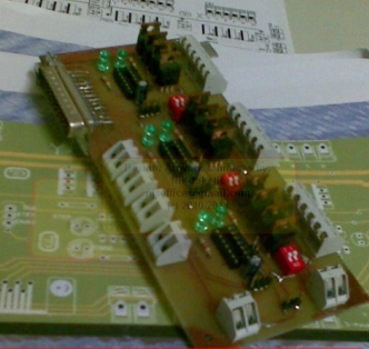

    Hi there astanapane!, i just read all threads and i have to congratulate you for your progress in programation, as i am a big fanatic to electrnonics and robotics. I have a request to anybody willing to help, i dont have a stepper driver as LEonardo has (big easy) but i made one with a 16f84a, i programmed it to receive a dir and step pulse from another pic, and to give the combinations to som mosfets and to the coils of the bipolar motor. At first it worked well with some weird movements sometimes, (i guess it wass because of the supply or some electrical noises), but as i have been studying, im interested in programming a pic to work as a microstepper driver. Until now, i know that some pwm are required to make the required signals to operate the coils, but i dont have it very clear.
    Of course, if somebody can help me out with this in picbasic pro i would be very grateful!. So teh basic idea is:
