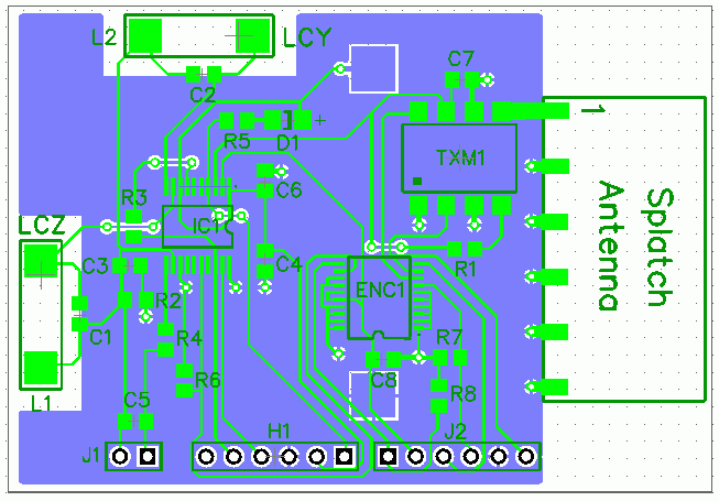

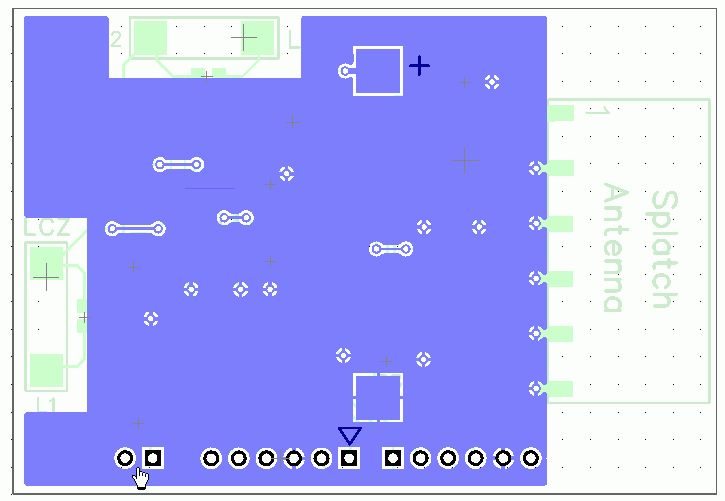

    Attached is an example of an RF transmitter board. The lower layer is all copper connected to ground.
    Last edited by Bruce; - 5th November 2008 at 22:50. Reason: Example screen capture of ground plane
    -Bruce

    Edit: What AL said is good info. If you DO include a ground plane on both sides of your board
    (make sure you have only 1 entry point from your power supply input) to both planes.
    I.E. the ground from your power supply input connects to the entry point of the plane. There
    should be NO ground traces to anywhere else on your PCB. Each IC should have a very short
    trace directly to a "via" that connects directly to your ground plane. A 4-spoke thermal connection
    point like the one in the attached graphic works extremely well - with single or dual planes.
