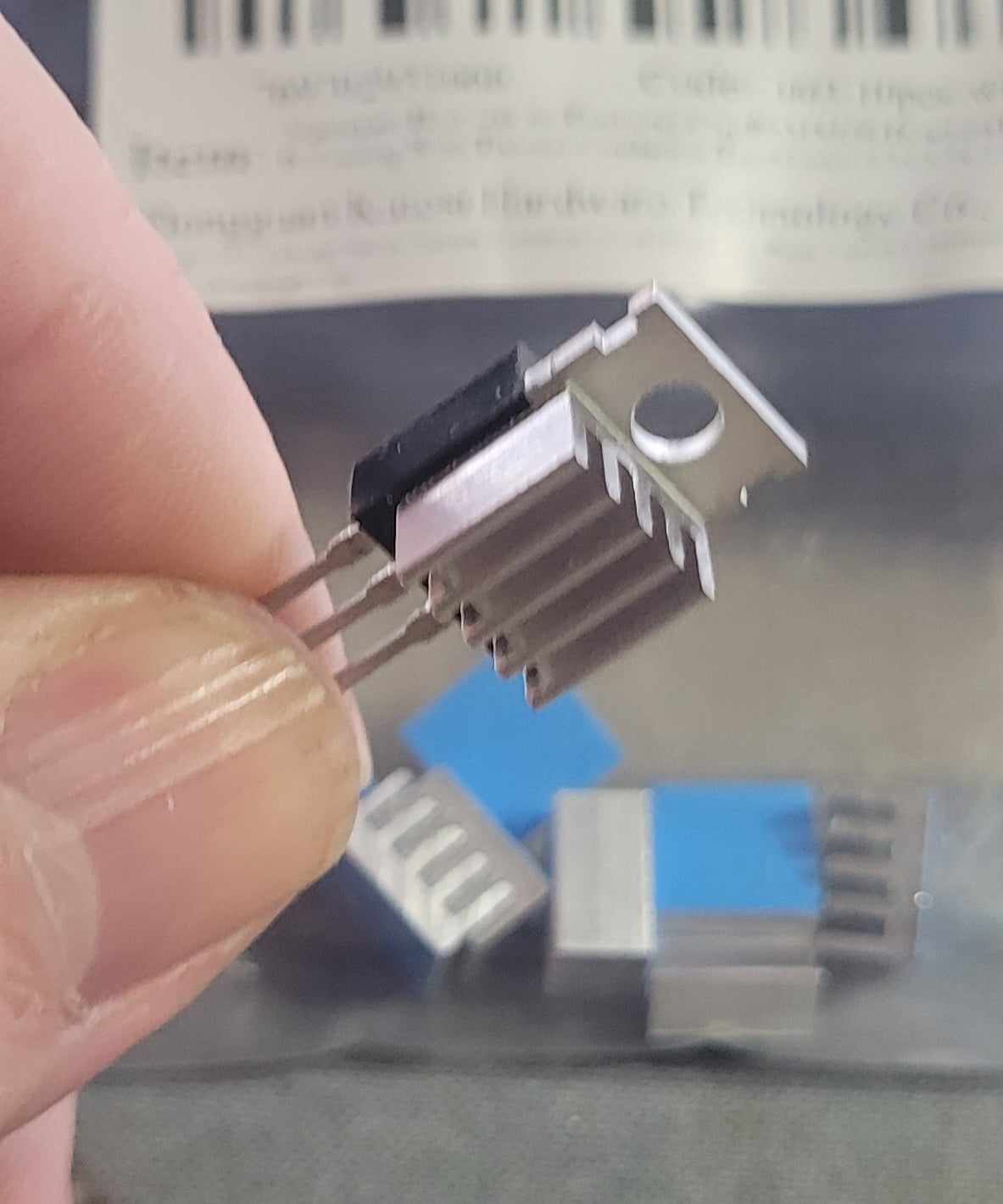

I bought a bunch of these a while back; aluminium heatsink with double-sided tape.
It fits just right on the back of a IRFZ44N (TO-220). I don't seem to have to bother with a screw/nut (unless you highly recommend a model with a fastener).
Attachment 9809
Aliexpress:
8.8 x 8.8 x 5, I tried removing the fin once attached, and it doesn't come off unless I usetools.
https://www.aliexpress.com/item/1005004079109702.html
My alternative was this screw/nut model with thermal paste for maximum efficiency:
https://www.aliexpress.com/item/32882672963.html
I'd just prefer in bare aluminium; I don't like paint on a cooling surface, seems counter productive to me.

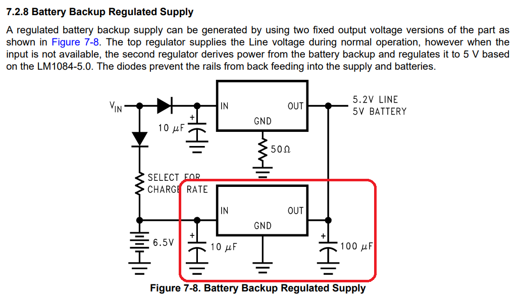

I did encounter a problem with the LM1084-5. Voltage drops when I add load.
I expected a specialized IC like the LM1084 to remain at a stable 5V throughout its workable current range.
I used the bottom of figure 7.2.8 with 2 electrolytic capacitors:
Attachment 9810
Re: Voltage regulation circuit 12V to 5V in 5A range
That 50 ohm resitor will worsen the regulating output. It forces the upper IC to have higher than 5V output but regulation depends now on the resistor.
Have you had a look at TPS565208? It is a chip with low noise and ripple, easy to use SOT-563 package, very small footprint and cheap. I would not mess with any Linear, heatsinks, wall adapters etc.
Only downside (maybe) is that it accepts only up to 17 volts DC. But if your source is upt to 12volts your are more than good to go.
I only used the bottom regulator on that schematic.

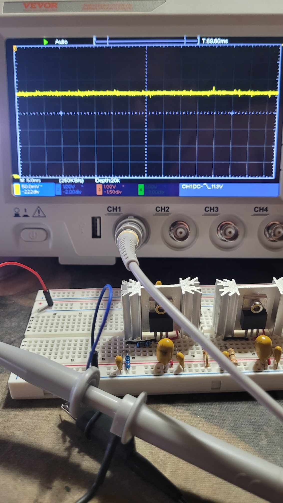

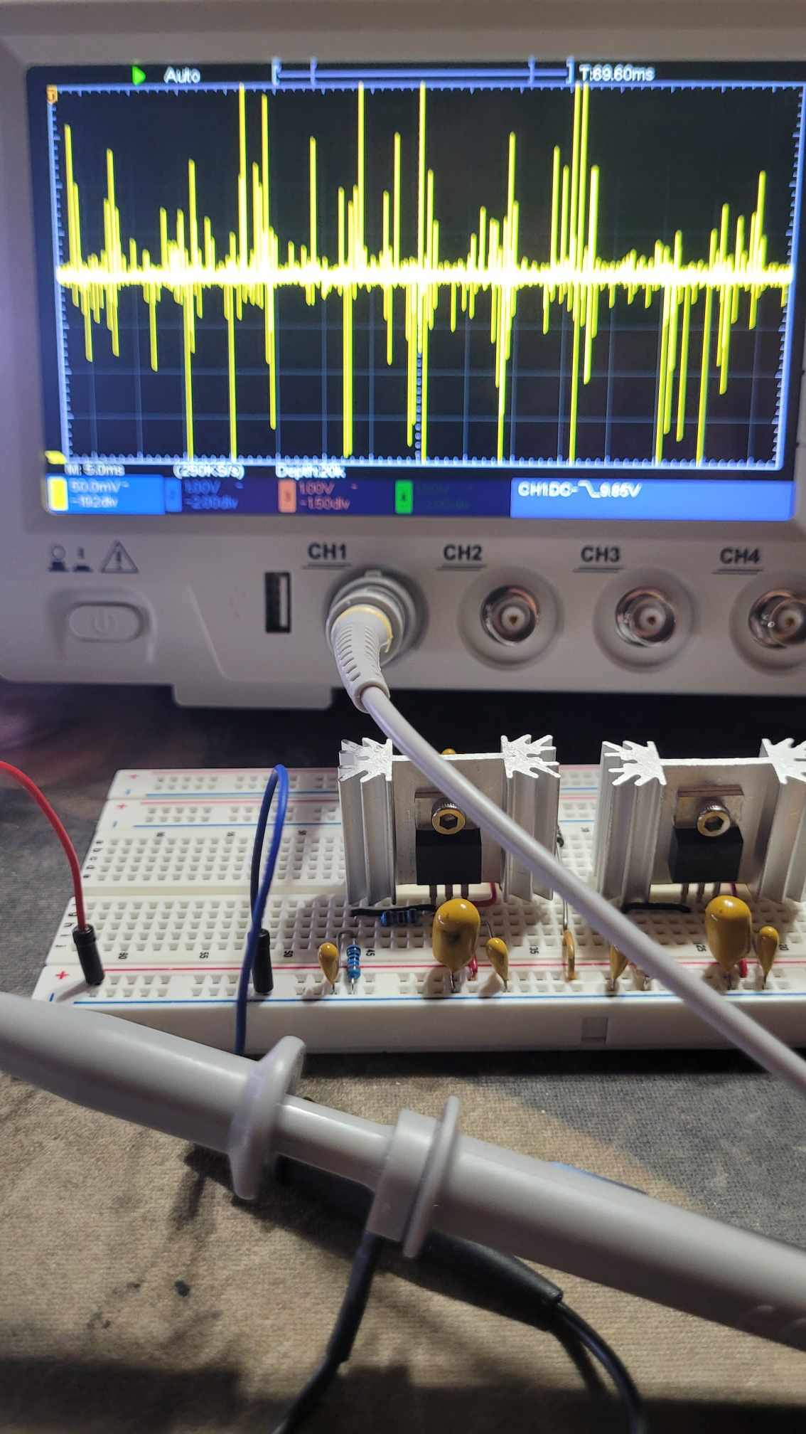

3 Attachment(s)
Received the LM1084-ADJ, still waiting on the recommended caps (to properly test ripples), but it's already running nicely with what I have on hand.
Also got a thermal imager to help identify hotspots. Looks like I fried 2 PICs with those 12V and 7V bursts (lesson learned).
LM1084-5V on right, supplies PICs, ICs and LCDs, essentially everything that is "always ON", with a slight tweak on ADJ pin to get it slightly above 5V to compensate for voltage drop.
LM1084-ADJ on left, supplies LED strips, cooling fans (to be determined) and anything else that doesn't care about ripples.
(HIKmicro E02)
Attachment 9814
Attachment 9815
No thermal compound yet, this was a temporary setup to help prevent forest fires.

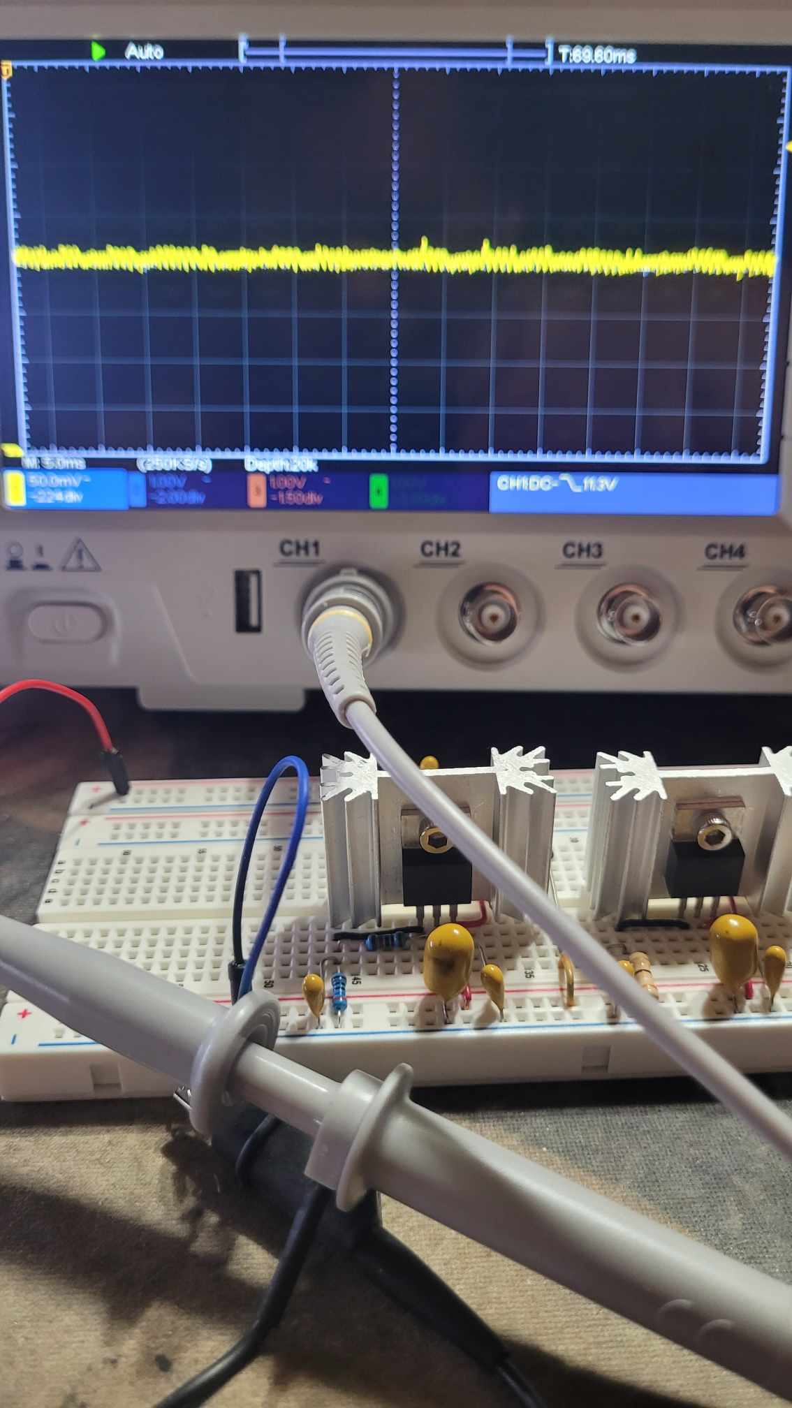

Wasted so much time trying to figure out why I STILL had a lot of ripples with the LM1084.
I checked directly on the wall adapter:
Attachment 9818
GIGO; can't expect the LM1084 to do miracles with that.
So I pulled out a 12V-5A Fqcmogu AL-1250 adapter (no idea what it's for):
Attachment 9819
Definite improvement.

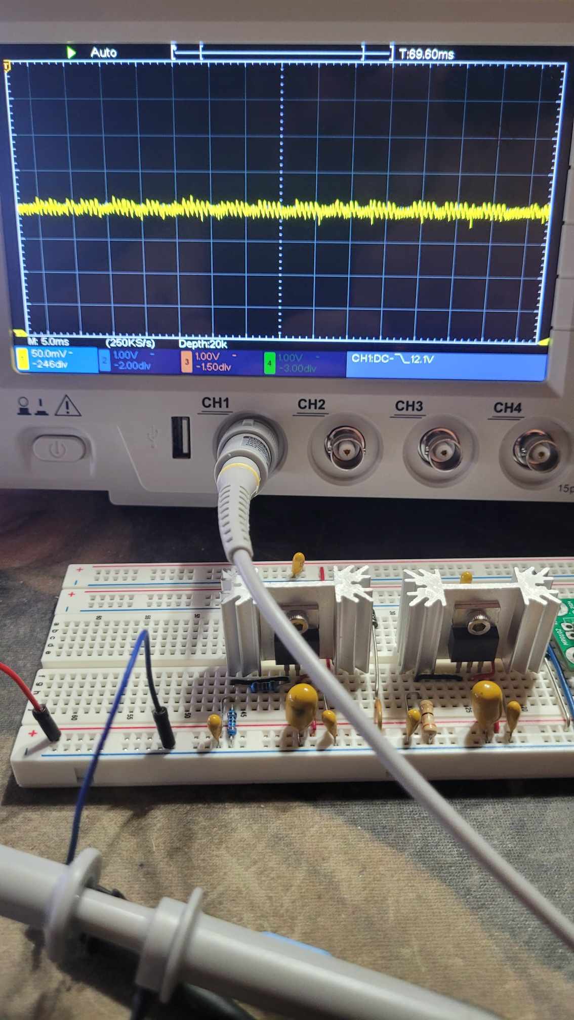

This is the LM1084-5V running at 5.0V (LED strips and whatnot):
Attachment 9820
This is the LM1084-ADJ running at 5.2V (PIC, LCDs and other ICs), note that is had less ripples as stated in the specs:
Attachment 9821

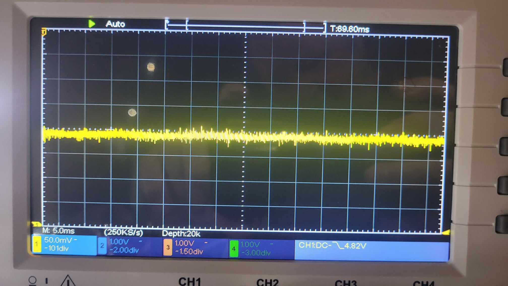

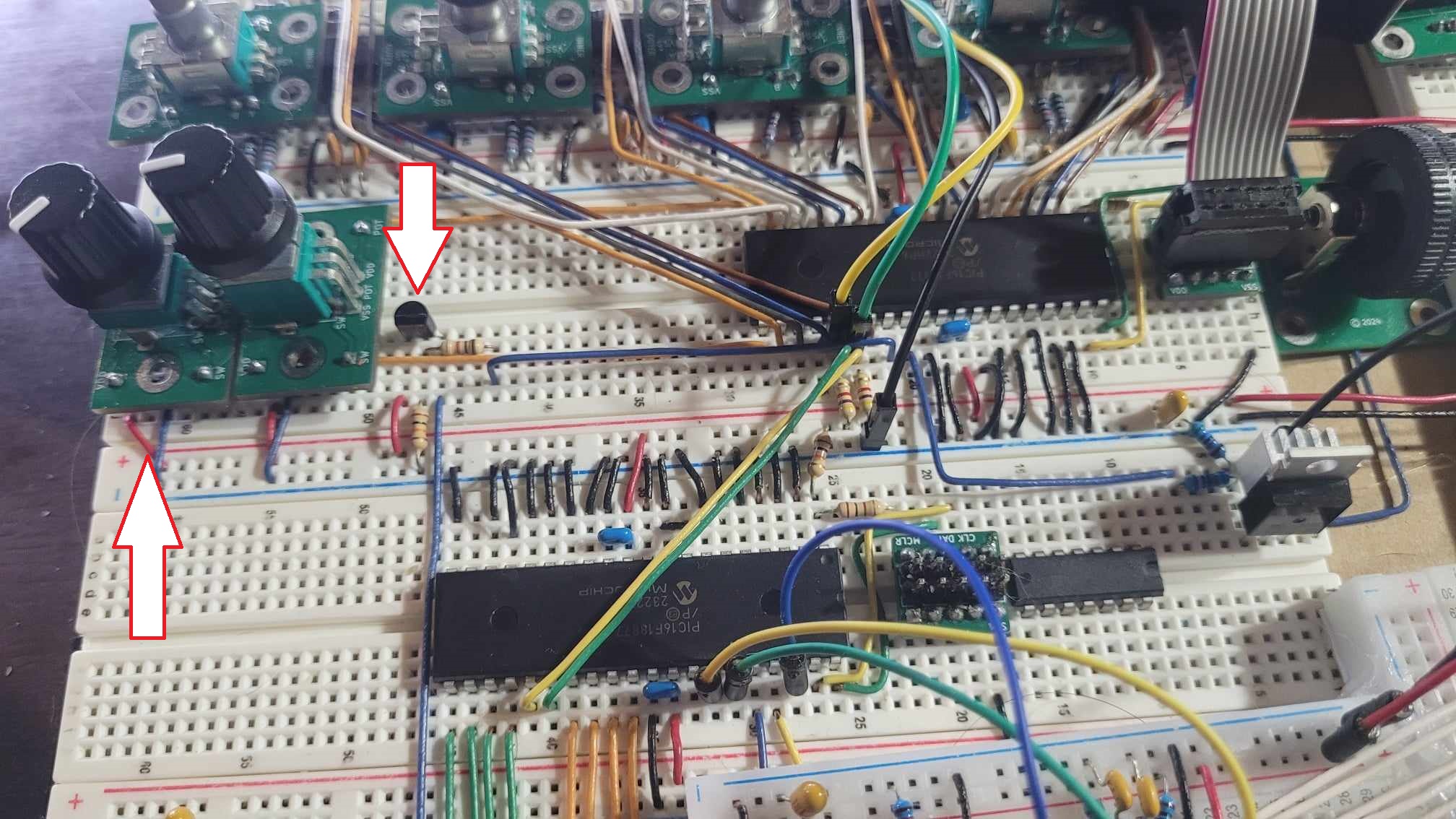

VDD with all ADC pots OFF; VDD is super stable.
Attachment 9822

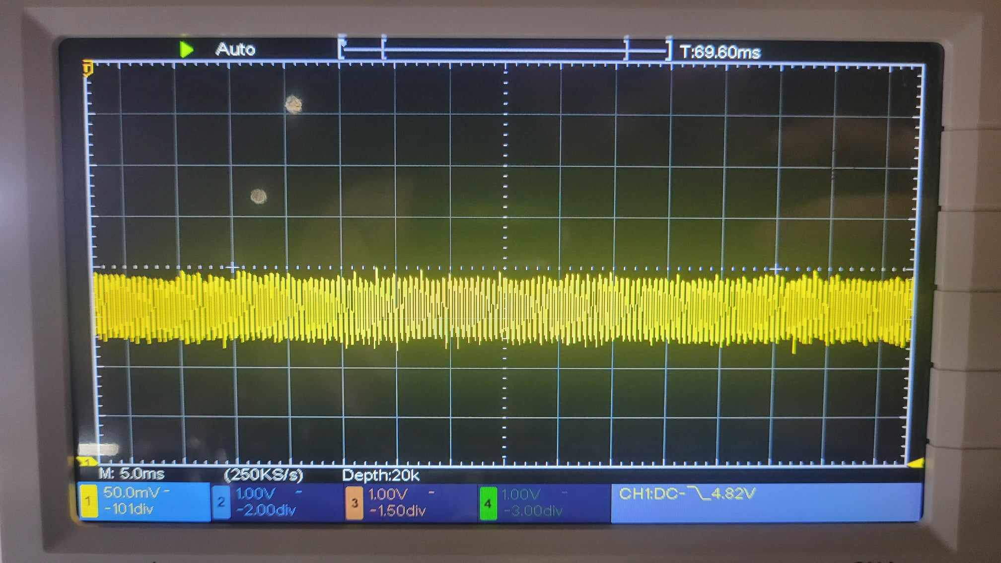

I control the contrast on all 4 LCDs with PWM on a 2N2907:
Attachment 9823
Guess what happens to VDD when I turn up the contrast:
Attachment 9824

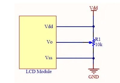

that seems a strange way to control the contrast.
how does it go if you set the contrast the normal way ?
Attachment 9825
anecdotally contrast by pwm needs a substantial LPF otherwise all sorts of nasty artefacts are introduced
perhaps a schematic would enlighten things

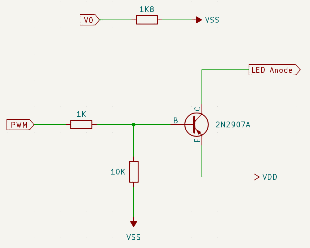

Sorry, contrast is hardwired to prevent the user from burning out the LCD. It's the backlight that's PWMed.
Attachment 9826
Backlight is controlled by PWM from a 2N2907A because it controls the 4 physical LCDs simultaneously as well as the radio in-game via USB:
Attachment 9827
does that drive all four backlights ?
where does led cathode go ?
if the cathode goes to vss then no wonder its noisy
the fet should make it worse
