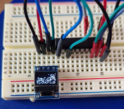

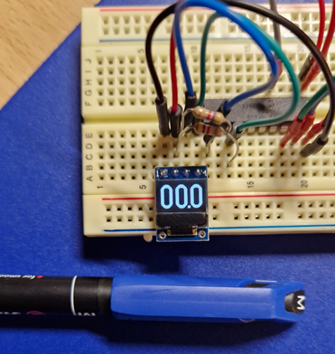

Hi there,
I juste received a bunch of very small (72x40) OLED displays driven by a SSD1306 controller.
Attachment 9476Attachment 9477
I have absolutely never used those displays, in particular the SSD1306 controller.
After a few searches in the forum, I got some examples but these don't really help unless I first understand the very basics.
So, would anyone of you have a code snippet I could start with and ready to share it or a good reference to understand the SSD1306 please?
For example, it starts right at the beginning: there seems to be a "display" address. Is this standard for I2C displays or should I get it from the manufacturer?
Voilą, that's the low I'm right now...
So again, if somenone has basic stuff to share, I would really appreciate :wink:

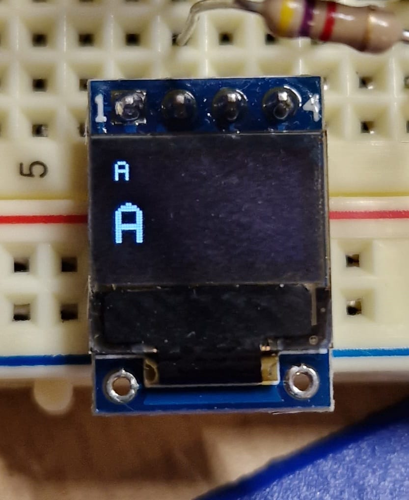

Re: SSD1306 OLED (42x40) I2C display from scratch
okay, first step done!
Attachment 9478

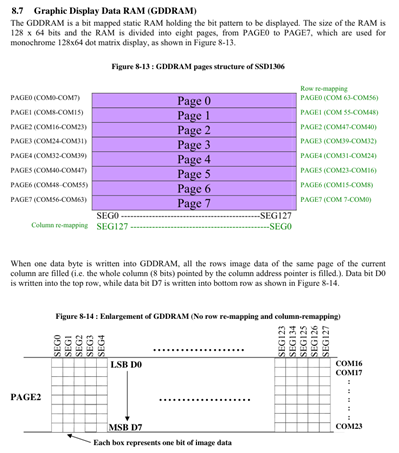

The latest version of the include is on post #90 of the link posted by ionnis reposted here for your convenience
this display is not something you can sneak up on easily , you really need a 100% solution before you can get anywhere
your 42x40 version will very likely need a few tweaks to match the way the oled array has been mapped onto the segment/com pins
and represented on the graphic memory overlay of the driver chip, i don't have one to experiment with
there is an alternative version here for p18 chips only that is more versatile, it would still need the same tweaks too
https://www.picbasic.co.uk/forum/sho...lays-with-PBP3
the init routine is fairly well commented if you read it in conjunction with the ssd1306 data sheet

SSD1306 OLED (72x40) I2C display from scratch
Only garbage at this time...but it's alive:)
Attachment 9480

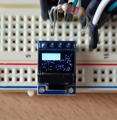

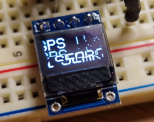

Seems that the character size is too big to fit there..
...still struggeling with the ssd1306's datasheet to understand the "page" concept and how to display things.
This is the simplest and shortest code I'm working with for now, composed of different sources I found in this forum and also on ARDUINO's one:

Up to now, I couldn't find any pixel map for the 72x40 display so I'm relying on information for the 128x64 one.
This is the information I have found in the 72x40 datasheet:
Attachment 9481
Can anybody tell me how I should convert this in "pages" if I have to do so? I don't understand how data has to be displayed...
This is the example from the 128x64's datasheet (to be found in attachment):
Attachment 9482
Some comments
is the display 72x40 of 42x40 ? you describe it both ways
the write window should be set to width and page height you require and the pixel/page offset to begin write from for proper operation
and
with your attempted title page transmission, sending every byte of data like that as individual senddata transactions is extremely inefficient the entire thing could be sent as a single data block in half the time

; you assume display is mapped from page 0 , this may not be correct ans could be 0,1,2,3
COM = $A4 : GOSUB SEND_COMMAND ' Disable Entire Display On
COM = $A1 : GOSUB SEND_COMMAND ' set segment re-map 128 to 0
COM = $C8 : GOSUB SEND_COMMAND ' Set COM Output Scan Direction 64 to 0

; cant see this working without setting a "window" to write into properly
' ====== SEND COMMAND ==============================================================================
SEND_COMMAND:
dc = $0
I2CWrite SDA,SCL,I2CDevice,DC,[COM]
dc = $40
; why not just
SEND_COMMAND:
I2CWrite SDA,SCL,I2CDevice,[0,COM]
' ====== CLEAR LCD =================================================================================
SEND_DATA:
DC = $40
I2CWrite SDA,SCL,I2CDevice,DC,[LCD_DATA]
; why not just
SEND_COMMAND:
I2CWrite SDA,SCL,I2CDevice,[$40,LCD_DATA]
' ====== TITLE =====================================================================================
;here you set 6 pages "Y" of data from page 0 to 7 with page 2 missing when a 40 pixel height can have 5 pages maximum
TITLE:

;attempt to set page to 41 when it cannot be > than 5 pages

Basically the display is 360 bytes of ram where every bit is a oled, the ram is divided into 5 pages each of 72 bytes
the 5 pages are overlaid onto a larger array that is 8 pages of 128 bytes, precisely where is not known to me [i have never seen one of those modules]
the ssd1306 is very versatile and allows vertical and horiz offsets to be set along with scan direction and various mem access methods to suit you.
to write to a byte you must address its x and y position , the width to be written and number of pages is also expected to be set

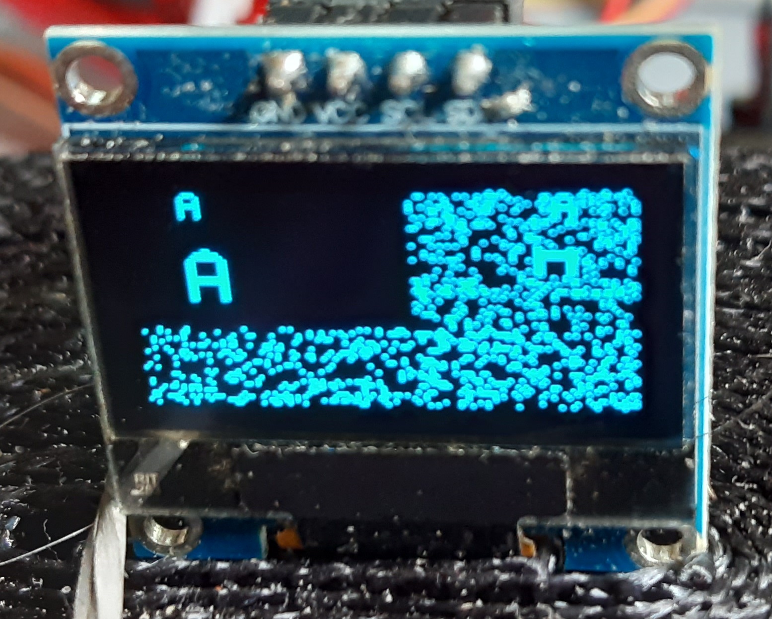

is this more clear ?
draws a 7x5 chr A and 14x10 A in a 72x40 window located @ x=0y=0 after clearing screen [ outside of window is just random noise ]
here's a pic on a 128x64 screen , there is no telling how it line up for your screen
Attachment 9484

Voilą.
As no caracter would display, I changed the fill caracter in the CLEAR routine to make someting visible.
Attachment 9489
BTW, the number of pixels displayed is 50x20
Attachment 9490

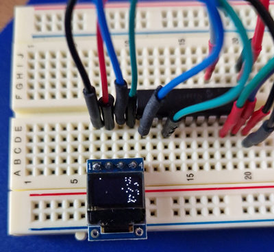

2 Attachment(s)
Re: SSD1306 OLED (72x40) I2C display from scratch
Quote:
Are you using my exact code ?
Absolutely!
With this "untouched" code, I get this display:
Attachment 9491
Then, with the new value of $67, here is what I get:
Attachment 9492

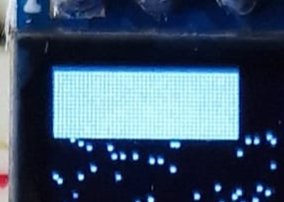

Thanks Richard.
This it looks now, with your code ni post #26.
https://drive.google.com/file/d/1Ud4...usp=drive_link

I also adjusted your code as:
' ====== PROGRAM ================================================== =================================
GOSUB CLEAR_LCD
MAIN:
'7x5 "A"
X = 28 : Y = 0 : GOSUB SET_7
I2CWrite SDA,SCL,I2CDevice,[$40,$fc,$12,$12,$12,$fc]
'14x10 "A"
X = 28 : Y = 2 : GOSUB SET_14
I2CWrite SDA,SCL,I2CDevice,[$40,$f0,$f8,12,12,14,14,12,12,$f8,$f0_
,$ff,$ff,6,6,6,6,6,6,$ff,$ff]
PAUSE 1000
GOTO MAIN
Attachment 9494

link worked.
all you need to do now is
1 create a 14x10 font with the chrs you need
2 workout an efficient way to store and retrieve the font
3 develop a nice way to plonk it on the screen
easy as pie
ps
if you only need numbers and "%" ,"." it could fit on a 16f690 easily
hint , pic16 flash memory is 14 bits wide, the ssd1306 can fill memory in vertical mode too
Thank you so much Richard!!!
I'll give it a try to create a super big font.
Let you know for any progress in the next days :wink:
First look at what it could look like :)
Attachment 9495
It looks great!
Well done Roger!
...credits are all for Richard :wink:

something to consider about fonts
it looks like you want 40x22 size font
a pic16 has a flash word size of 14 bits therefore a font that size
will take if encoded horizontally by row take 2x40 words per chr
it will take 3x22 words if encoded vertically by column a reasonable saving.
one of the benefits of the ssd1306 controller is that it can address its graphics ram either way with ease
Attachment 9497
