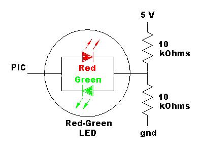

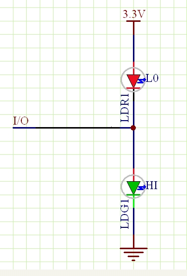

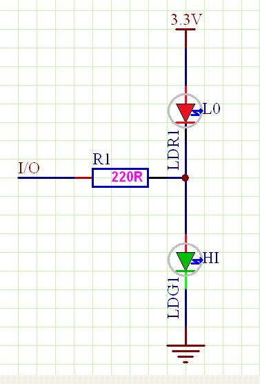

I have one red LED and one GREEN led and a few resistors and only ONE pin left on my MCU. It would be nice if there is a way to turn on green or red or have them both off.
Since the pin has 3 states it might be possible but today my brain just can't see how. Current goes in .. one LED is on... Current goes out.. the other one is on. But it is possible to have them both turned off without haveing any leaking current when the pin is in tri-state?
I never plan to have them on at the same time... just both off or one or the other on.
