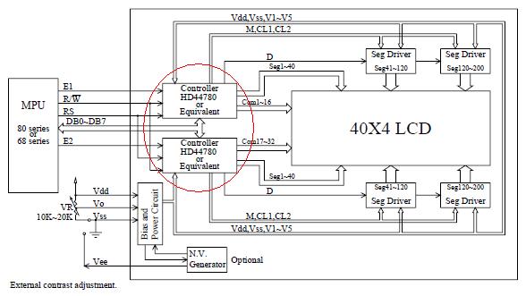

Be aware that 4x40 LCD's are a little different and have 2 controllers (and 2 chip enable lines).
