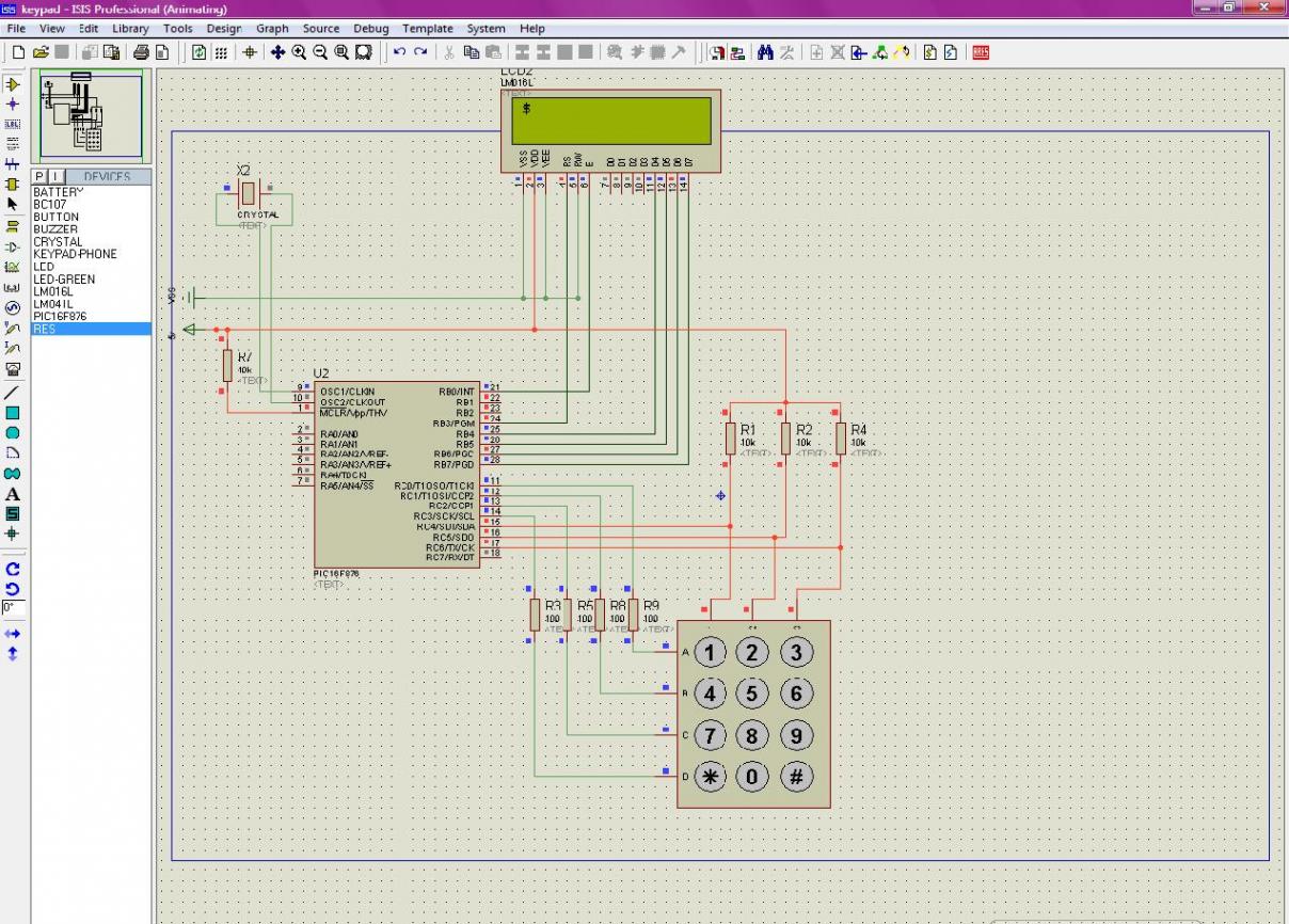

Hay guys and girls. I've been playing around with this coding this afternoon and i keep getting errors and when i dont nothing going as i thought it should so any chance somone could point out whats wrong please or point me in the right dirrection at least!
My main coding:
Code:TRISA=%00000011
TRISB=%00000000

forgot to put the error code

YUP, that's what happen when you don't check the spelling of your DEFINEs. DEFINEs are case sensitive. So PORTb have to be written PORTB, and so on with all others.
;) Cheers, so any clues as to whats wrong now? i dont get any reaction on the LCD and i get several ports flash high then low
well...
looking at your schematic bellowCode:DEFINE KEYPAD_ROW 8 ' 8 row
define KEYPAD_ROW_PORT PORTc ' on PORTB
DEFINE KEYPAD_ROW_BIT 0 ' <7:0>
DEFINE KEYPAD_COL 4 ' 4 col
DEFINE KEYPAD_COL_PORT PORTc ' on PORTA
DEFINE KEYPAD_COL_BIT 0 ' <3:0>
http://www.picbasic.co.uk/forum/atta...6&d=1227197183
There's some problems there for sure... You don't use a 8X4 keypad ;)
DEFINE KEYPAD_ROW 4
DEFINE KEYPAD_ROW_PORT PORTC
DEFINE KEYPAD_COL 3
DEFINE KEYPAD_COL_PORT PORTC
DEFINE KEYPAD_COL_BIT 4
Thanks yet again mister_e! You should move in with me, that way i wouldnt have to use the net to bother yo every other day :p
and yes i put the dec2 myvar on the lcdout command so all works now :)
