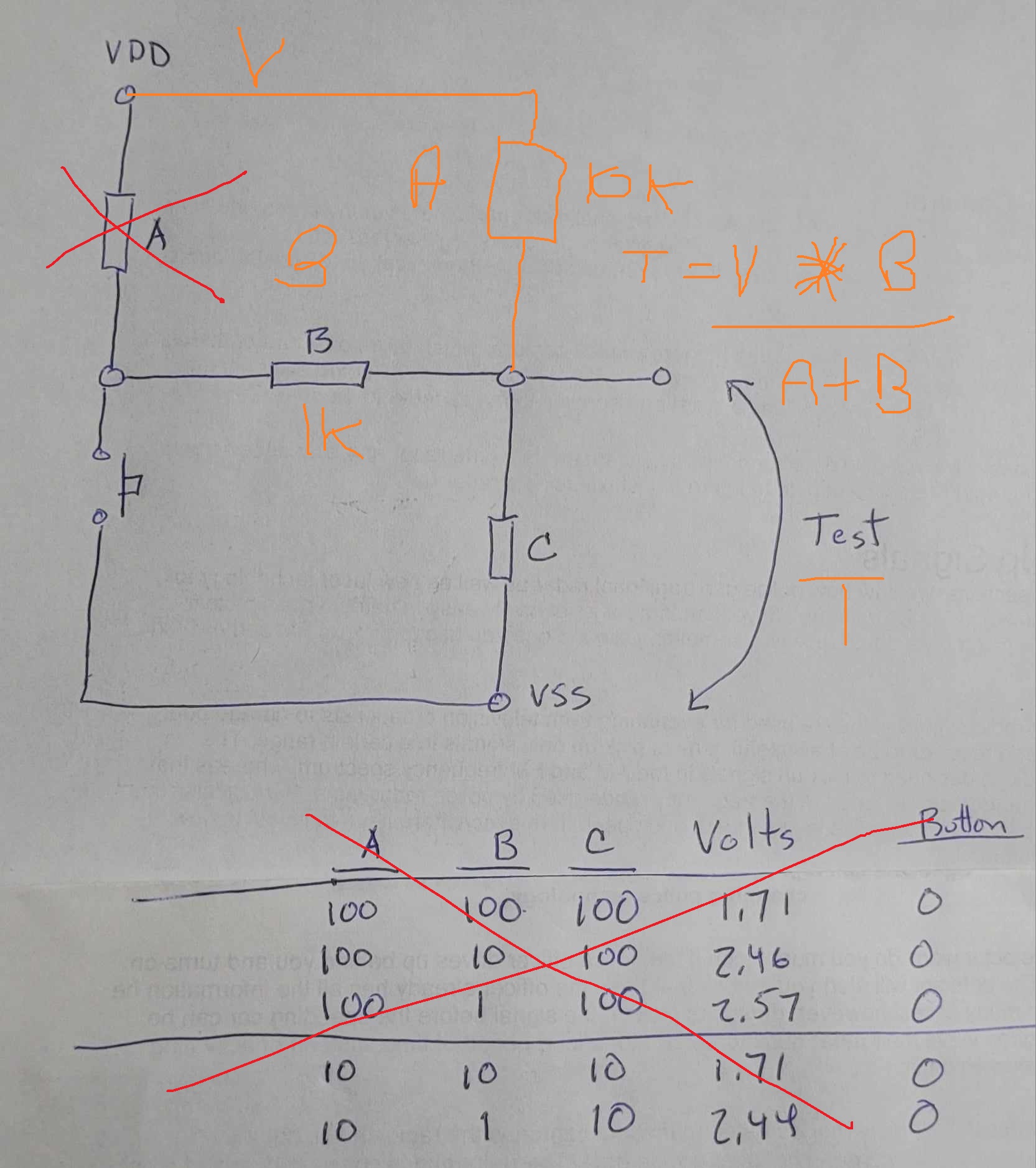

I'm going to test this using 10K pull-up and a 1K res and see what that turns out (I'd like to do the math, but my hair hurts :D ).

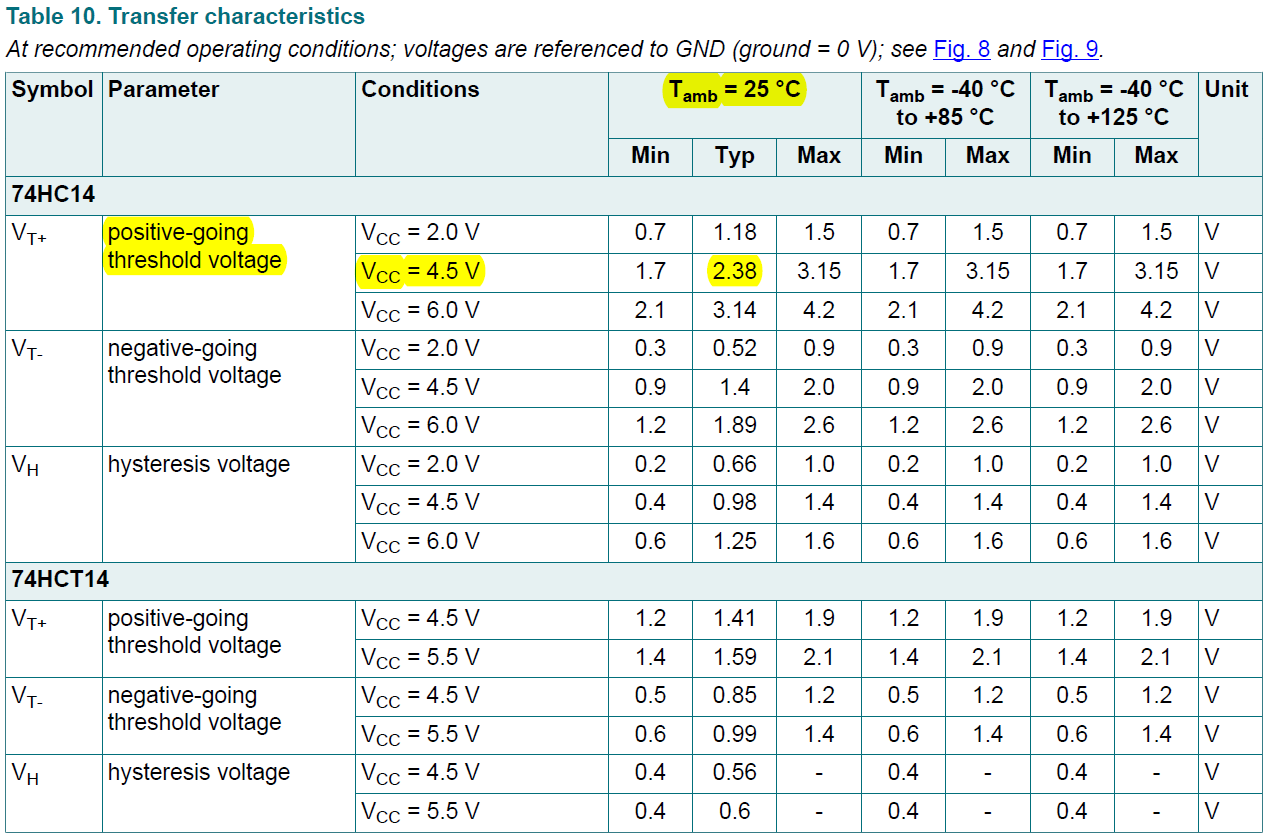

You just need less than 2.2 volts at the input for the HC14 to interpret it as low. So, yes, either 100k/10k or 10k/1k combination is OK. Better 100k/10k though, because it will draw much less current.

I can't do math since I can't remember squat. It's faster for me to pull out the breadboard and test it out. This is what I got:
(corrected cause I'm senile)

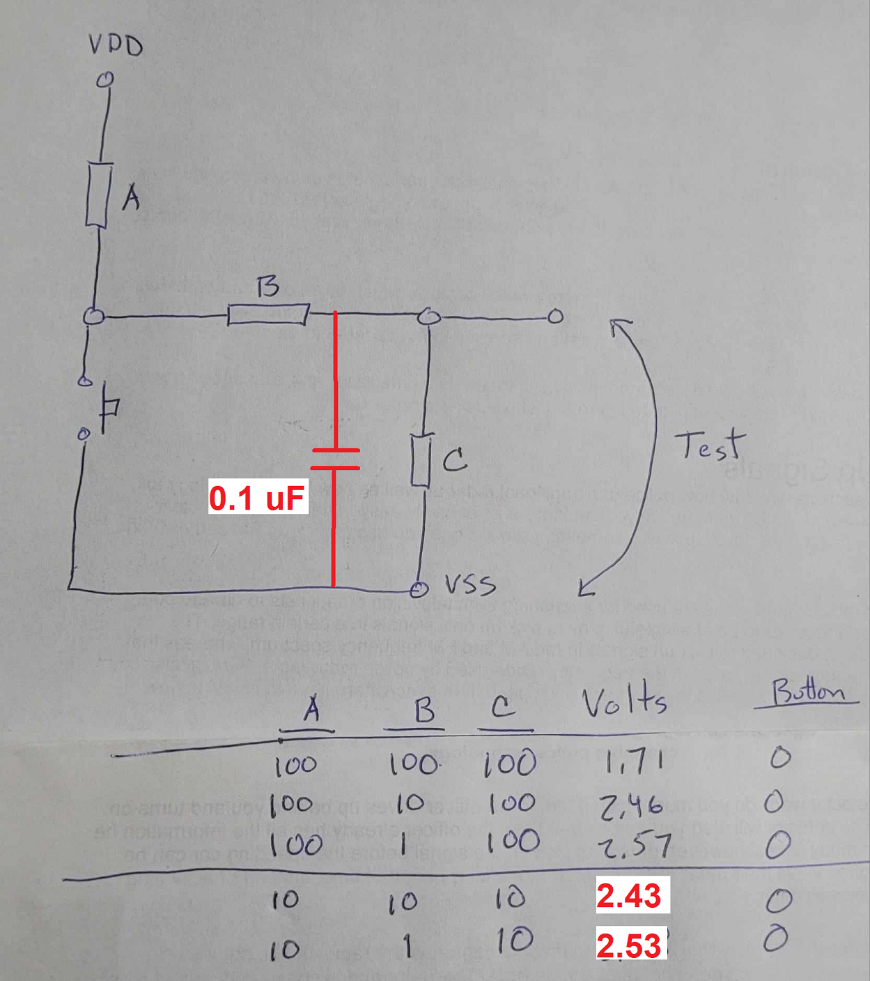

It looks like I'm better off using 100K-1K-100K or 10K-1K-10K to be sure to be in 2.5V range. I didn't check current consumption.
I suppose the dude on that link used the 74HCT14 (at the bottom of specs). The positive-going threshold is about 1.5V, depending on VCC.

you sketch is incorrect , with button pressed v test == 0.45 v
Attachment 9560
I used this guys design.

I've seen this design in other places. The 3rd resistor is to prevent the input pin from floating.
i see , you need to know the leakage current from the ST gate input to calculate the voltages . after the rc time constant is allowed for of course
seems messy to me , at 100k the button may never work depending on ST characteristics
Oooops. I've since added a pull-down for the input I was using.

the pull down resistor is a bad idea, the hackaday article [if you wish to trust it] does not have one and does not suggest one.
biasing cmos inputs to values inbetween logic high and logic low thresholds is a proven method for making oscillators , i would not recommend it as a debounce cct. the input pin in the article is never in a floating state regardless of button state, unused cmos input pins cannot be left to float, a completely different thing
I guess you refer to post #89. There are no pull downs. It was a graphic design error that meant to be a capacitor, as designated by the letter C.

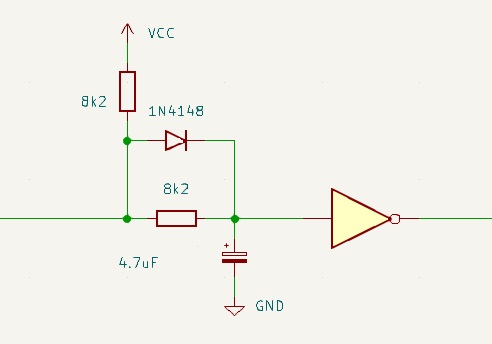

This cropped up recently on arduino forum as a debounce in noisy [automotive] enviro as an effective debounce method
Attachment 9563
Yeah, I've saved an article from February 2020 about this one too:
