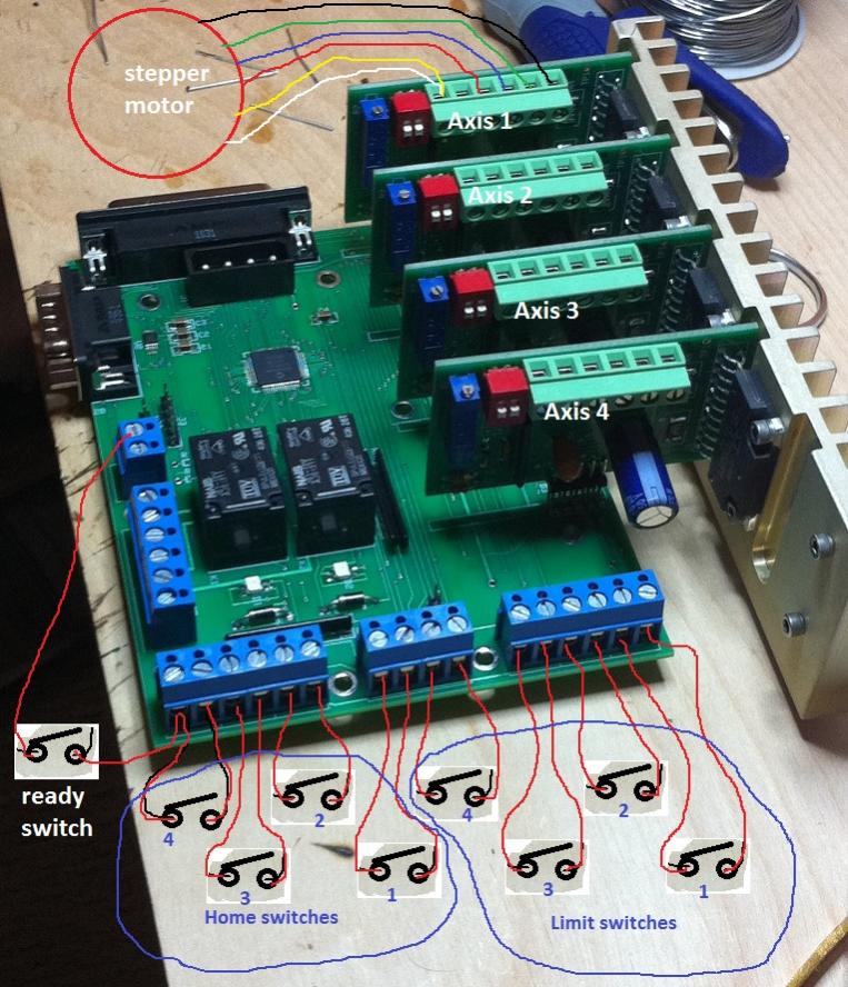

Finally got past my logic issues, Just thought I would post a pic of the card with stepper drives attached.
Attachment 5167
Thanks to all who have helped me get this far. This is a fully functional "phase 1" card. Now the fun really begins :)

Nice!!!
Looking forward to seeing vids of it running.
Thank you,
They are coming Dave :)
