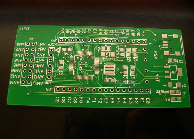

Ok, it took about three weeks, but I just received my order from batchpcb / Sparkfun. The board looks pretty good! Thanks again Bruce! I still need to get a few parts to put it together though. Once it works, I will place an order for at least 40. Sounds like dhouston found a pretty good deal from ezpcb, so I'll probably give them a try. Here's a picture of the board. The good thing about this order (not sure if this was just a fluke) was I got two of all 3 boards I ordered, but I only paid for 1 each of the three.... Anyone else tried them before?

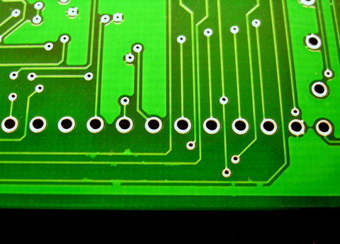

Edit: One out of the six boards I received has some problems. It just happens to be on one of the StickOS boards. The trace E1 on the back side of the board wasn't fully etched, and in at least two places, this trace goes to ground. The other boards don't show signs of this problem. Probably just another fluke..... Anyway, here is a picture of the pretty side.....
Attachment 5288
And ugly side....
Attachment 5289
Well, at least they gave me one free one, I guess I can't complain. And after a little work with an exacto knife, they both should work.
Thats great! Despite the little shorts. A knife would make the job OK.
Looking forward for the working board :)
