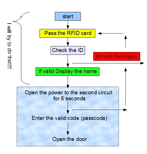

So now what is the thought.
1) to be able to open the door using an RFID tag.
2) the rfid tag might be unique and stored in an eeprom
3) once we pass the tag from the ID-12 module the pic will recognise the ID of the tag and display on the 16x2 the Name of the carrier.
4) after the Displayed name (0,5 seconds) the door will open.
5) there we need to clear everything and be ready to use an other tag.
Now We need to think to use the 16x2 display and the RFID module with the same pic.

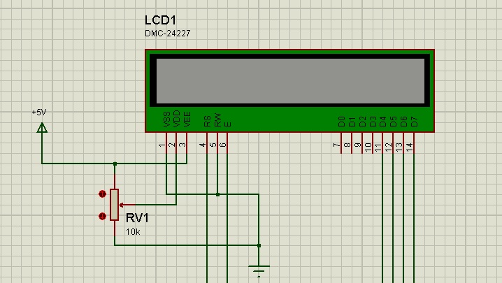

1) From my point of view i need for the display 6 ports reserved from the PIC. (see attached file)
we also need to give the above code at the beggining of our program in order to specify the parameter of the display.

The attached file shown what i need to do with the ID-12 and the pic16f628a.
I will seperate those in two circuits.
The first circuit will read and identify the RFID cards and the second circuits will be based on the 3x4 keypad.
Once you pass the rfid card from the ID-12 the circuit will check if the card is valid or not.
If it is valid then will proceed and display your name. If not then you will need to go back and check card again.
Once you are accepted from the system then you only have 5 seconds to open the door. You will need to type your 4 digit code in order to open the door.

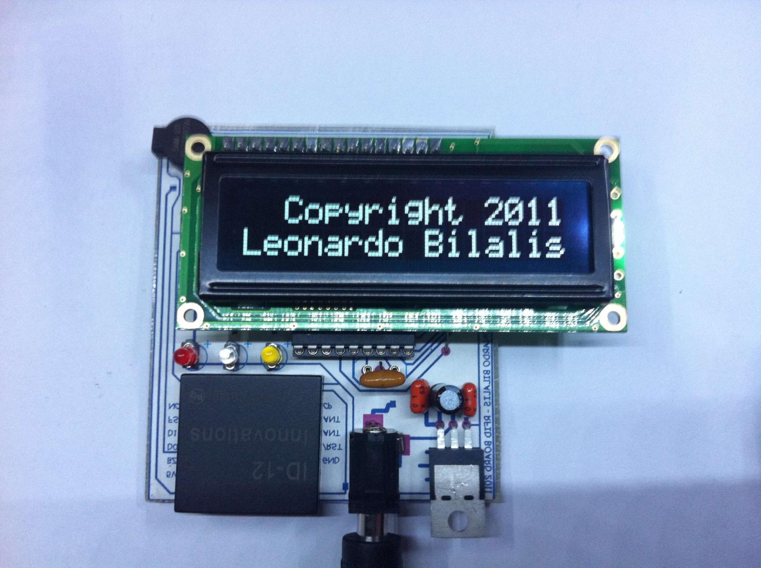

hello all again,
i just received the RFID module 12 from sparkfun.
I test the serial usb device with Secure CRT and works fine.
Now i'm building the circuit and the code.
As i told you i would like to make a code that can display the name of the holder according to the ID of the RFID tag.
I havent connect the ID-12 yet because the dimensions of the pins are not much to the standard ones. I will make a pcb this afternoon and then i will try to make a schematic.
Now i have attached the code i have done so far, copied most of it from the people here in forum.

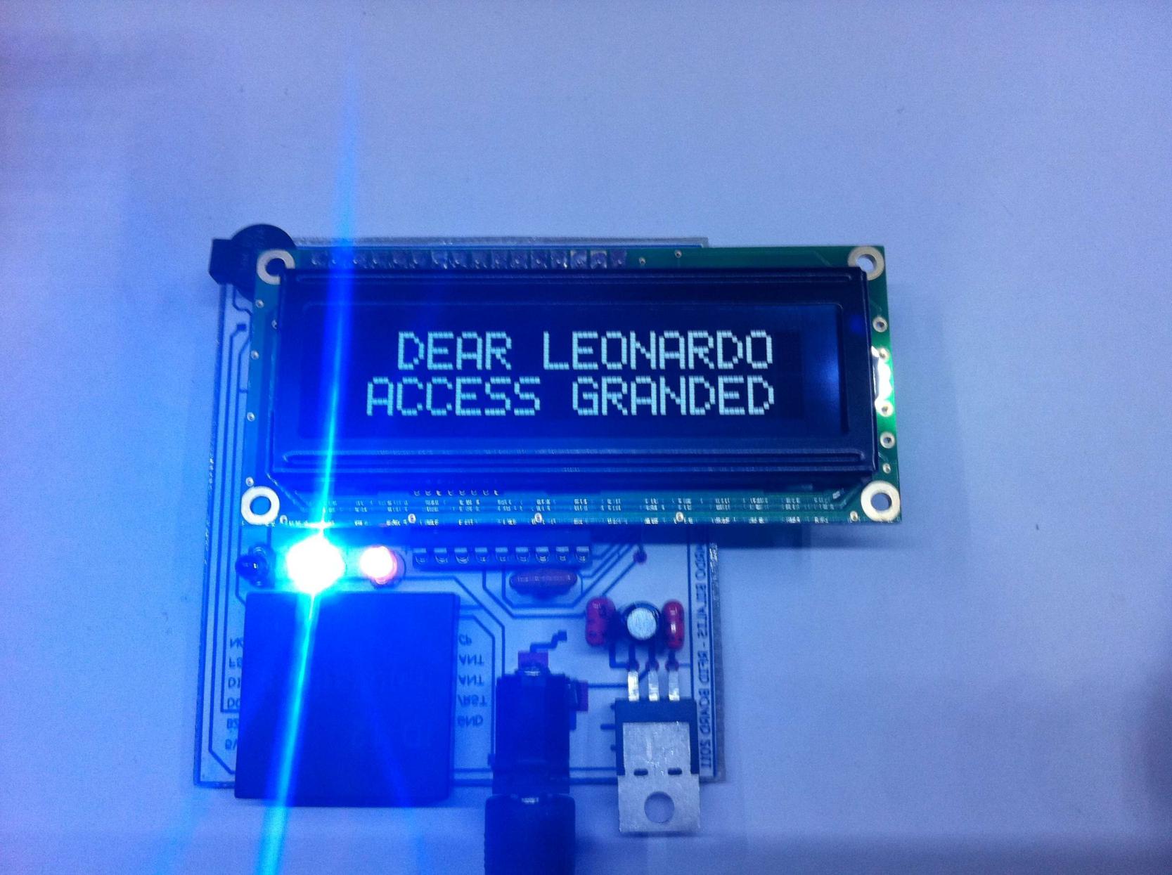

i would like to know if i can use the command serin2 on the pin portb.1 on the pic16f628a in order to read the data.
I know that the code may have a lot of mistakes but as i told you i'm not a programmer and i try to make it as good as i can.
I only need a little bit of your help in certain points that you sure know better than me.
thank you all for your help in advance.
Re: How to compare strings/array? RFID Project
hi all,
i did some small changes and read data on 9600.
But i cannot make it work yet.
When i pass the TAG from the reader does not display the name.
It displays 'Bad Dag' only. And the tag is the valid one i pass from the reader.
Could you please help me with my program?
hi all again,
i try to see what the problem is.
I think there might be a problem on storing data to EEPROM of the pic16f628a...
and there also be a problem somewhere on the code...
high portb.3
low portb.1 ' activate the reader
SERIN2 portb.1, 84, [WAIT($0A)] ' STR buf\12] ' wait for hdr + ID
high portb.1 ' deactivate reader
Check_List:
FOR tagNum = 1 to 2 ' scan through known tags
FOR idx = 0 TO 11 ' scan bytes in tag
READ (((tagNum-1) * 12) + idx), char ' get tag data from table
IF (char <> buf(idx)) THEN Bad_Char ' compare tag to table
NEXT
GOTO Tag_Found ' all bytes match!
when i try to pass the card from the reader it light the led of the reader but nothing happens to my LCD.
then i pass second time the card from the reader the led on the porta.3 light up and i get on my lcd the Error tag.
I dont understand what is happening on the first time that i pass the card. It doesnt do anything.
Why when i pass it two times i have bad tag on the display.
On other thing is that i cannot make it work to show me the name on the display on the right cards.
If you have any solutions please help me.
hi all,
this is my code for your reference....there is somewhere a mistake that cannot find.

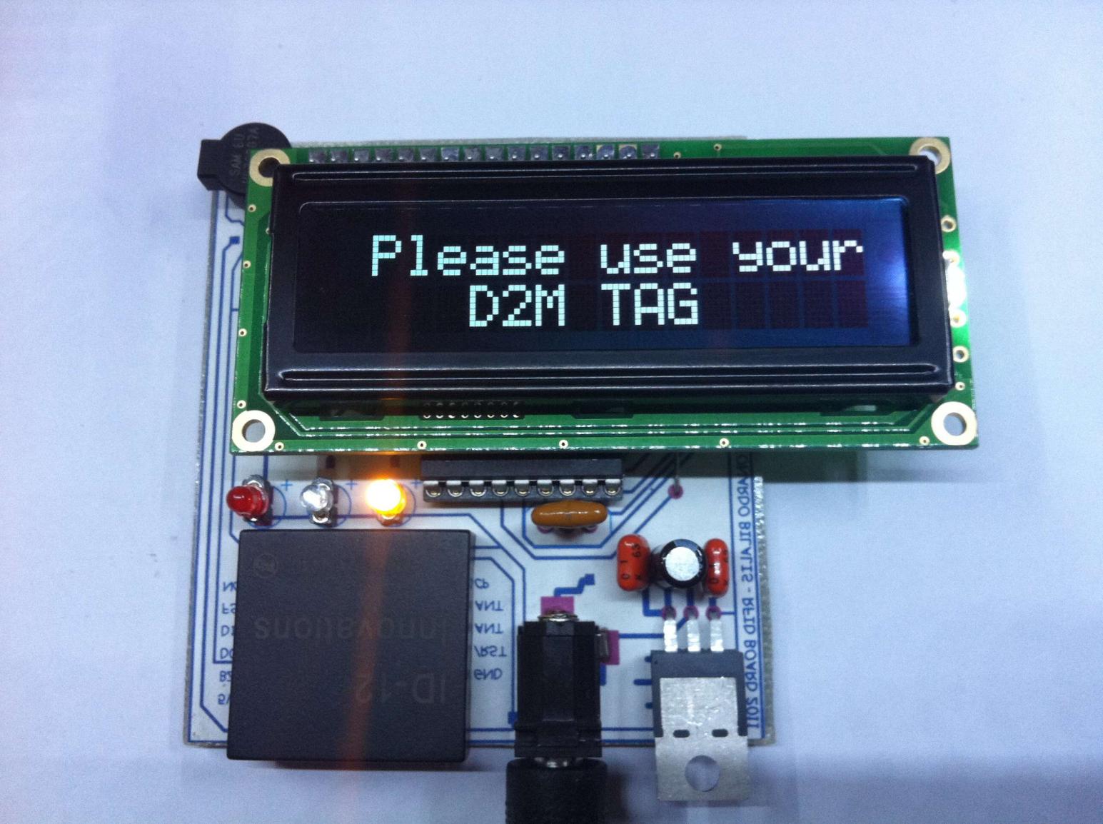

lcdout $FE,1," Please use your"
lcdout $FE, $C0," TAG"

displayName1:
lcdout $FE, 1," name_1"
lcdout $FE, $C0, "ACCESS GRANDED"
I do not know what the 0A is there for.
It for sure NOT for the ID-12.
In ASCII Hex mode,the ID-12 sends a STX (Start Sentinel) of 02 as the data sheet state.
So no WAIT(0Ah). It will give Bad Tag message.
On the e-mail I sent to you there was an error as I did not read correctly the Data Sheet.
Correct one is the
serin2 port_pin1,baud_rate1,[wait($02),str buf\10]
serout2 port_pin2,baud_rate2,[str buf\10,13,10]
just to test if the reading data are correct.

4 Attachment(s)

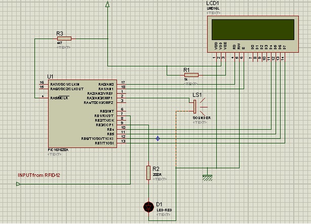

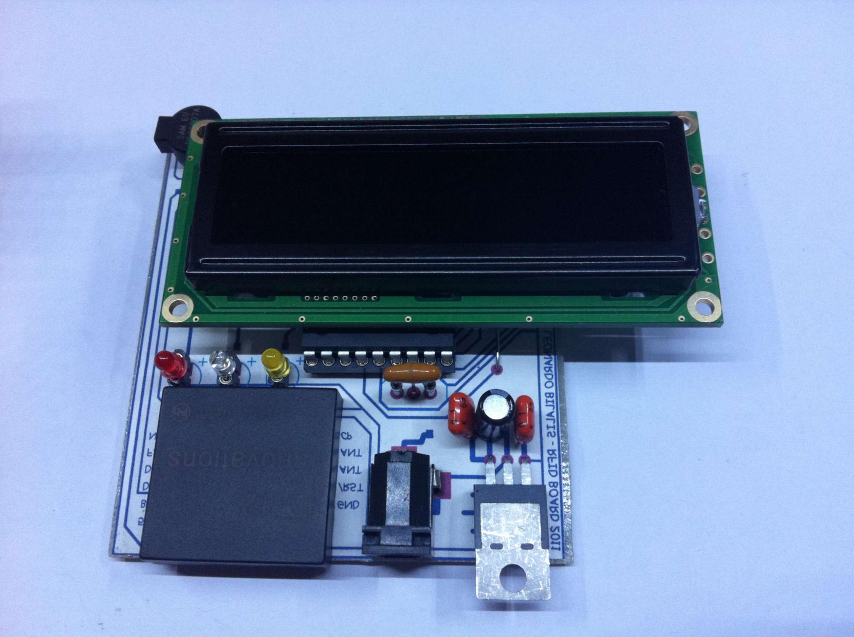

Dear All,
thank you very much for your help. Ioannis helped me out to identify my mistakes on the code and he also gave me the right instructions in order to solve the problem.
i would like also to thanks, Joe, Bruce and Gevo for their support.
Please find attached pictures of my circuit.
here you can see a demo of the RFID circuit.
http://www.youtube.com/watch?v=0cp1Y1U_XGk
I need now to improve it with GLCd and Keypad.
i would like to say thanks to Mr. Ioannis for his patient and help.
regards,
