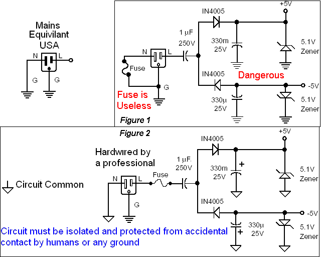

Quote:
Originally Posted by Melanie
In this case, the circuit will protect itself but kill the user !
The big difference between ground and "common" or "neutral" is the voltage drop that is developed on the neutral wire due to the fact that it has the same current flow as the line conductor (What goes out must return) (Load current x DC resistance of neutral conductor between receptacle and breaker box= Voltage difference between neutral and ground at the receptacle). Normally the voltage drop is neglible except in long circuit runs with higher current loads. The neutral and ground wires are normally connected together (bonded) at the breaker box. I totally agree that the fuse definitely needs to be in the "hot" or "line" or "mains" line to perform a safety function.
This whole thread, I think, is on the brink of veering off!Quote:
When U are choosing a very low cost alternative there are many conditions
which are subject to be adhered. first being a circuit a "live" it is not to be
used as any run of mill usage like powering something which can get body
contact. Secondly if "safety" being prime concern then why use "transformerless " supply at all? If I have to get 'risk' of capacitor shorting
eliminated I would rather use a double wound txr and add the cost to safety
of supply!!! Some people are just attached to fancy of some components and
don't look at overall concept of a circuit or device.
How nice it will be if everyone should consider to buy a Merc or BMW as
it won't let U down in middle of road like small car?
For Melani's information we men like to live dangerous but do consult
our purse before risking our reputation in hotel or pub !
Nice to see the modified diagram but U have missed a vital component.Quote:
Originally Posted by Pic_User
There should be small resistor like 22 Ohm( Ur LAW) to 47 ohm in serries
with 1uf/250V capacitor ( Melani wont approve of this ).Otherwise in few
days that capacitor will be reduced to open circuit (if of metallised film
type) or get short (if Film foil type) and whole ckt will go up in smoke.
The resistors should be atleast 1/2 watt type ( 1watt better). A high value
resistor like 220K is better placed across capacitor to protect user if he
accidently touches capacitor even when ckt is disconnected from mains.

I have designed and made a fridge controller (Blind type) with 555 and
similiar transformerless power supply some 3-4 years ago. I have used
normal 680n / 250V capacitor --( our system is 240V 50Hz) and those are
working nicely last 3-4 years and saving 100s of Rs. every month for the
users without any recall.

Originally Posted by sayzer
well here is the schematic. Im not so good in drawing like U.
I had a fridge which had thermostat gone bust. So I made this ckt and
saved lot of energy 0.75KWHr /day instead of 5KWHr/day. I also found
that most of fridges have improper settings evenif the thermostat is OK and
there is lot of frost and they consume abt 3-4 KWHr/day. So making a
commercial unit costing Rs.400/- ( $9 appx.) have installed in abt 20-30
homes and they are all saving energy down to 1KWHr/day.
The consumption of unit is less than 05VA and there is no area even feeling
warm. I cant afford to use X2 capacitors in this as that will push cost of unit.

Melanie,
I have tried to emulate your schematic and have found that without the 5V Regulator the ciruit provides 11.7 V, but as soon as I add the regulator or put any kind of load across the circuit it drops to almost nothing. Does anyone have any idea of why this may be happeneing?
and yet another SIM victim... trust me and Melanie, it's circuit works.
Just for my own curiosity, which SIM did you used?
Interestingly, I designed a similar circuit myself early last year. Few variations with mine. Used two TO220 regs. (LM7805 & LM7812 1 amp packages) Plus I also have a bit more available current due to full wave rectification. This arrangement also makes the circuit a little safer too. The low voltage rails are tied close the Neutral line of the 240VAC mains, so provided you connect to a correctly wired GPO (240VAC socket), most of the circuit is nominally at low potential. (*Claimed by Silicon Chip publications)
Anyhow, I discovered a whole bag full of problems with this circuit on the bench. In theory, it all should have worked. In practice, I found that the 5 & 12V regs were unable to deliver the goods. The circuit was pre-calculated and should have been good for about 1.2W of power- 100mA on the 12V rail. The 12V rail failed to provide even a third of this. I have no explanation to the problem and my thoughts are entirely inconclusive. I discovered only about 20mVPP of ripple in the raw DC rail supplying the regs. This is more than an acceptable level of AC component.
In the end I settled for two zener-based shunts to produce 5 & 12V rails respectively. Circuit works well.
Trent Jackson
Off-Load the VDR clips the upper voltage from climbing too high. But if your supply is crashing, then you are trying to draw too much current - that actually is an additional safety feature. If you measure the volts across the supply Capacitor, you'll find the whole lot appearing there.
If you just put a 5v Reg (like a 78L05) in circuit and your output crashes, then (a) your Regulator is defective, or (b) your main supply Capacitor is the wrong value for the current you're drawing or itself defective.
That circuit and the values given is good for 10-30mA total. You can measure how good the circuit is by putting some Resistors in series with a meter set to mA across the 11v VDR. Put another voltmeter across the VDR. Now increase the load (ie decrease the Resistance) until the voltage just starts to drop to say to 10v. That will the the maximum (total) useable current from your PSU based on the main Capacitor you're using.
20-30mA?, lets see...
XC = 1/ 2Pie(FC)
= 1 / 6.283185307 x (50Hz x 0.00000047F)
= 1 / 6.283185301 x 0.0000235
= 6772Ω
Now, there's a 470K bleed resistor in parallel with the cap.
XC = 1 / (1/ 6772) + (1 / 470K)
= 1 / ( 0.000147666 + 0.000002127)
= 6675Ω
As you can see the 470K only knocks about 100Ω off the total reactance.
For those who don't know, reactance in an AC circuit is like resistance.
Rectified high voltage rail from RMS value (full wave rectification)
= 240VAC x 1.414
= 339.36VDC 'Peak value, has same heating effect as 240 RMS
(half wave rectification)...
= 0.637 x 339.36VDC
= 216.17VDC Average
Absolute max current (short circuit)
= 216.17VDC / 6675Ω
= 32.38mA
There's a 5V rail being produced from a LM78L05. It's input VCC must always be at least 2.5V greater than the output in order for it to maintain adequate regulation.
Absolute max current @ 5V
= (216.17VDC - 7.5VDC) / 6675Ω
= 208.67VDC / 6675Ω
= 31.26mA
Absolute max power @ 5V
= 31.26mA x 5
= 156mW
Spot on. In the perfect World, Melanie's supply should be good for about 30mA.
Component tolerances often compromise the accuracy of calculated events. Such is life.
Trent Jackson
Want more power from this circuit? No problem...
Clearly, the third calculation - (full wave rectified high voltage rail from RMS value) - shown in the previous post tells us that rectifying both sides of the sine wave is beneficial.
Lets see how much current we can squeeze out using full wave rectification.
XC = 1/ 2Pie(FC)
= 6772Ω
= 6675Ω
High voltage DC rail - (full wave rectification)...
= 240VAC x 1.414
= 339.36VDC
= 339.36VDC / 6675Ω
= 50.84mA
= (339.36VDC - 7.5VDC) / 6675Ω
= 331.86VDC / 6675Ω
= 49.71mA
= 49.71mA x 5
= 248mW
% More power
(248mW / 156mW) x 100
= 59%
That's quite a significant increase. You could also push things even further by
decreasing XC - use a larger cap or parallel a few together. Practical limitation of such a circuit is about 1W. Takes up too much real estate and defeats the cost-effectiveness of it otherwise.
All told, it's better to use a transformer...
Trent Jackson

Can someone explain to me how the 240VAC after rectification can come down to +12VDC?
Are you kidding me? I have enjoyed the arguments a lot, and from the first post to the third last (subtracting yours & mine of course), I have come across 2 to 4 circuits all making 12VDC. Check them out going back few posts (Remember to use X2 capacitors with mains - else Melanie would not like it - in case she comes across your circuit :eek: )
Strangely, i have a design for a transformer-less PSU in the making...
My reason for not using a transformer is because to have a transformer that drops 110V and 240V down to a more usable voltage and supply the current i need would be massive and it costs >£50 each...
I'm not going to post details of the PSU because i intend on filing for international copyright.
The reason for this is because it will handle any single phase voltage, frequency and amount of noise (or noise only) you can throw at it.
It will even operate in a brown out with sustained unstable voltages as low as 24V (maybe lower).
It can also handle stepped AC, Square wave and saw tooth signals provided it is alternating...
Also, Mel is absolutely right, that AN is written for one purpose and one purpose only... TO KILL PEOPLE!

transformer-less... the above has a transformer, i can tell because of the input specification.
Here in the UK the current code for mains wiring dictates the use of an ELCB.
Earth Leakage Circuit Breaker. If more than 50mA flows up or down the earth wire the ELCB will trip isolating both live and neutral.
every time I've diagnosed wiring faults, their has always been a 50 to 60 V AC difference between earth and ether neutral or live...
If you use an isolation transformer you can connect the negative after rectification to ground. This is what most PC PSU's do.
