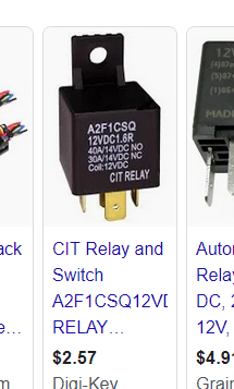

Re: Leaves the mainloop???
for that type of thing, I would think a relay would be appropriate.
Attachment 9447
