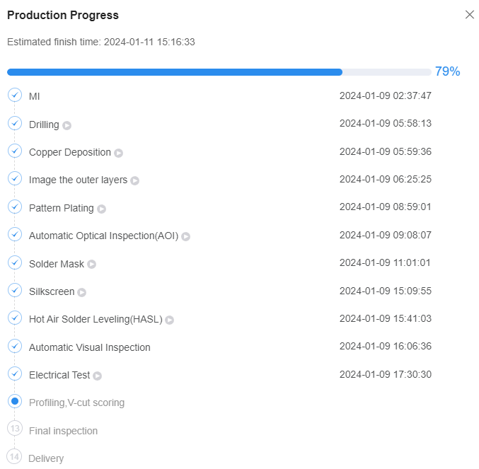

Ioannis, check this out.
Couple switches, buttons, resistors and LEDs, along with a truckload of holes:
https://i.imgur.com/fWdFSIj.png
The exact same circuit without the holes:
https://i.imgur.com/We6D2nC.png
I guess they've moved away from milling the boards with endmills, but have moved on to waterjet (this is my first guess) or laser.

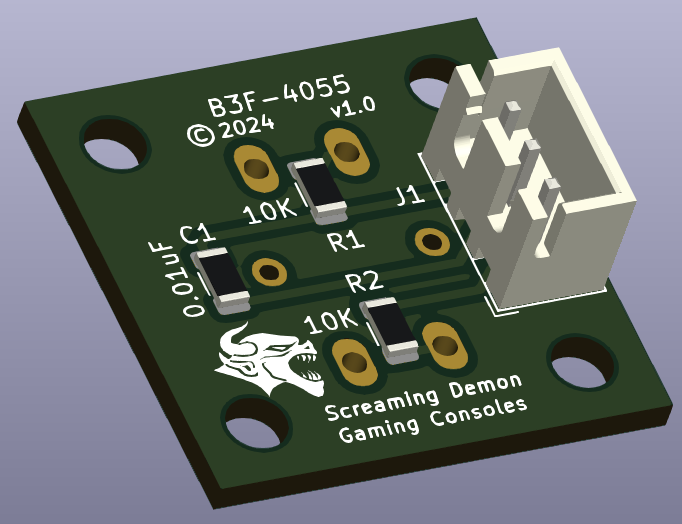

3 Attachment(s)
Re: New project - MSFS C++ USB interface
Figured I'd draw myself a logo from the start. Demon was my online racing name for over 20 years in the NASCAR Racing Series from Papyrus.
I got these from the DreamStudio AI image generator. I took the one from the bottom left and started tweaking it.
Attachment 9542
The fine lines looked like crap once imported and shrunk in Kicad. So I used a LED tablet as backlight and traced it.
Attachment 9543

The nice thing with the image converter in Kicad, it removes the pixelation along the edges (used windows PaintBrush for cleaning up). It may not be professional, but it's unique. :D
Attachment 9541

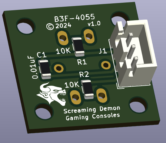

Tweaked some stuff, but I could touch this up forever and I'd still find something.
Attachment 9544

You really have to go through the entire estimate process to get the actual shipping fee, as well as customs and taxes. In the sample I tried, it went from $0.15 each to $0.30ish each.
I'm using clean ($2.10) and de-panel ($4.19) as well, that way boards should be relatively ready to use when they arrive. These fees were the same whether I did 3x3 or 10x10 panels (I didn't change the quantity, these were for 5 panels, I assume it'll increase for more panels).
It's kinda cool how they maintain an update of the entire production process. I made a small order of 5 units of single boards, just to learn how things work from A to Z. My real order will most likely be for 5 of 10x10.
Attachment 9546
Yes, it is very impressive the workflow!

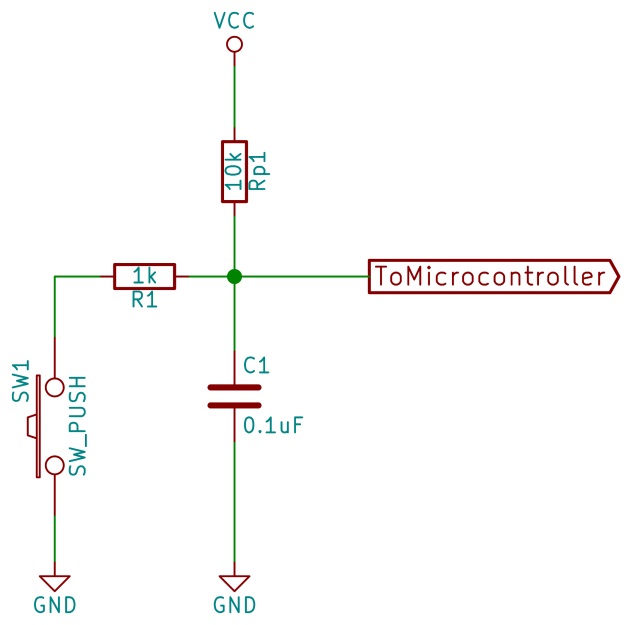

Well, I understand the case. With the I/O expanders things are different.
A very good debouncer is desribed in the second part of the article you post. Really neat and ultra fast technique with very low MCU load.
https://hackaday.com/2015/12/10/embe...ttons-part-ii/
But amazing things can a capacitor do! In most cases, with relatively good switch, a series resistor from the switch to the input and a small increase in the capacitor, that is in parallel with the input to the ground, is enough. Used that many times and with rotary encoders too with great results.
The secret is to use that resistor R1 in the following design, to "isolate" a bit the switch from the capacitor.
Attachment 9550

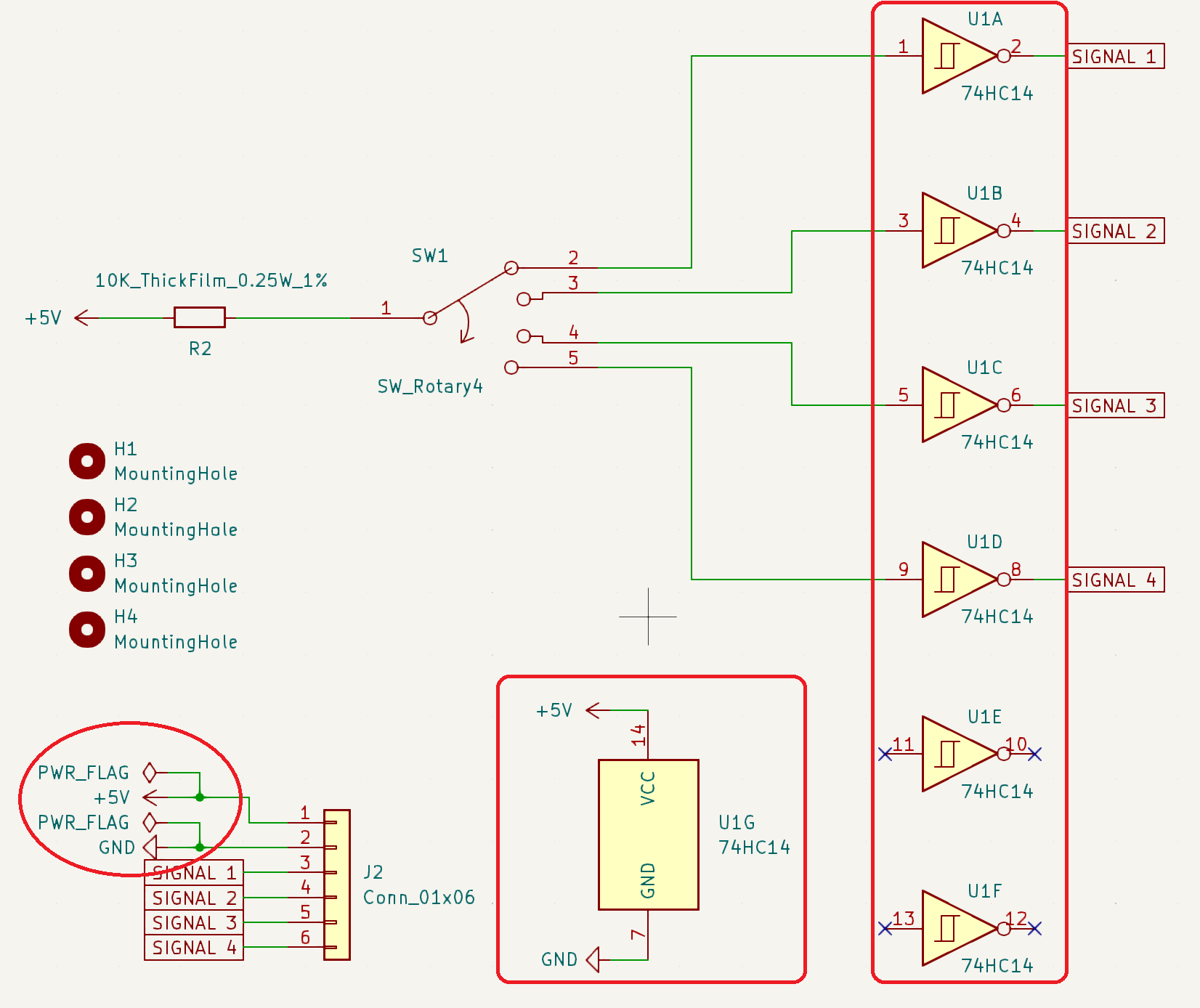

I can't say enough good about KiCad. It even has SPICE, but I never got to learning exactly how to use that.
I can generate all the files for a new circuit within a few hours. I can't imagine not working with it now. I love the Electrical Rules Checker; that saves a ton of time, money and effort.
It takes a while to get used to some of its way of doing things. There's a LOT of information on the web for any error I encountered; like having to add a PWR_FLAG to VDD and GND lines, and how symbols can be divided into units).
Units are essentially individual layers for components with multiple functions, like a 74HC14 chip with 6 circuits and the power circuit. In this example, I use only 4 of the 6 circuits. I'm putting the decoupling caps near the pin on the MCU (it's a separate circuit).
Attachment 9551
And best of all, it's free. :)

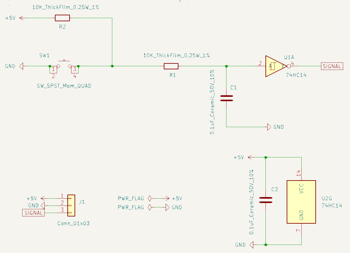

Why is the PWR_FLAG necessary to be added? Isn't +5V enough?
You shouldn't leave the inputs of the HC14 floating... the outputs will be unknown.
Also, an ST gate really won't debounce anything if that's what you're trying to do.
Yes, inputs should not be in the air.
Also despite being ST inputs, the resistor and a cap should still be added. Tubleweed is very right about that.
Quote:

In order for KiCad to be able to test the circuit, it has to know where the current is coming from. I just noticed how one dude uses a tiny legend to connect the flag with VDD and GND. You only need to connect the flag on each once.
https://forum.kicad.info/t/erc-error...nd-gnd/39364/5
Quote:
Originally Posted by
tumbleweed
I wish I had seen that before sending that order to JLCPCB. I'm gonna have a resistor jumper on my brand spanking new circuit (only printed 5 to test). :D
Attachment 9552
tumbleweed
I'm trying to get a cleaner signal like he explains here at "Hysteresis: The Full Fix".
Are you saying this doesn't work as he explained?
https://hackaday.com/2015/12/09/embe...uttons-part-i/
It will work if you included the RC network also. But NOT as in your post #69, where switch go directly to the HC14 input.

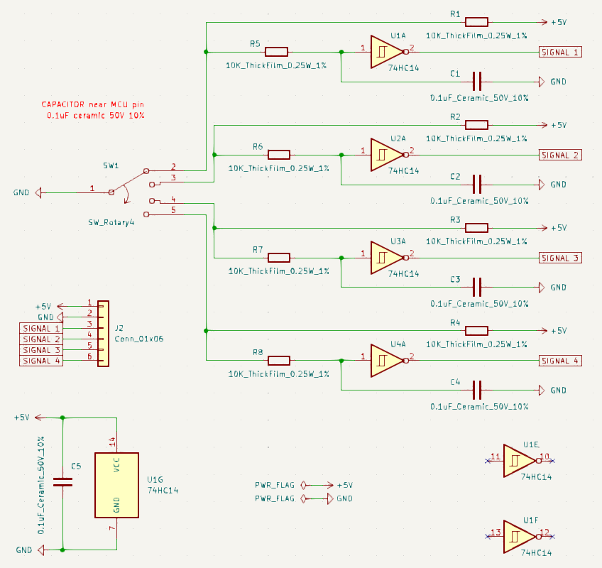

2 Attachment(s)
I really shouldn't work until the wee hours in the morning. That rotary switch circuit was totally not finished. :D
I've updated my pushbutton circuit.
Attachment 9554
And my rotary switch circuit. (CORRECTED VERSION IN NEXT POST)
Attachment 9555
1. Do you see any other mistakes?
2. Do I still need a cap at the MCU pin when it's a signal from a 74HC14?
EDIT: Hmmm, just noticed my pull-ups on the rotary switch are between the 10K and 74HC14. Gonna go change that.
Thanks!

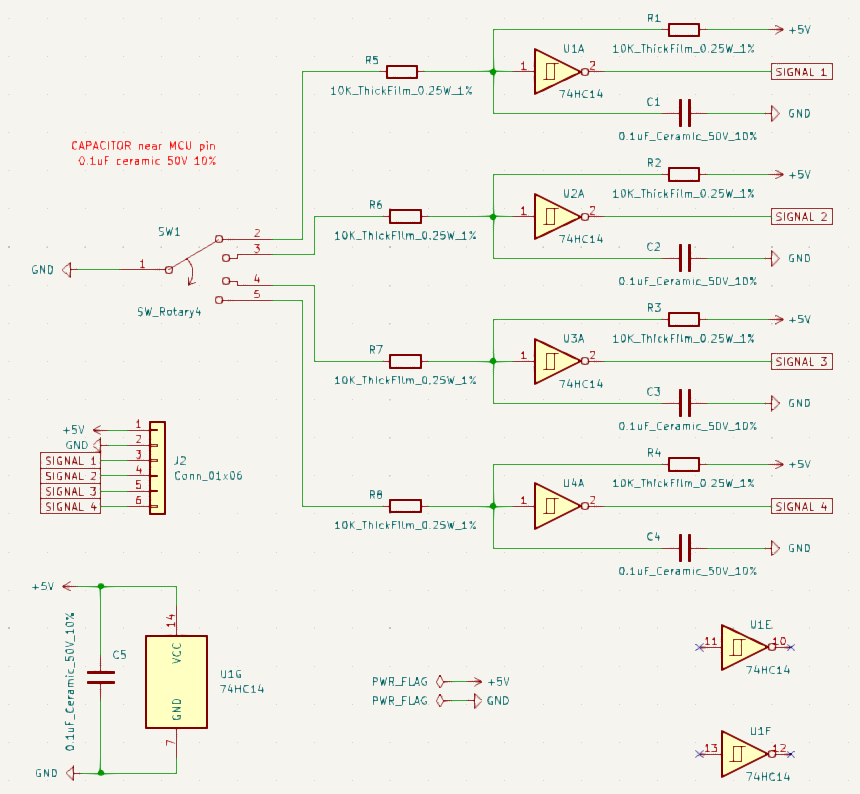

Here's my corrected rotary switch with corrected pull-ups.
Attachment 9556
Well, better but not perfect I suspect.
The HC14 inputs are at High (~5V) level when not triggerd by the switch/encoder.
When the switch is at ground, the HC14 sees the voltage divider of two 10K resistors, so the voltage is at 2.5Volts.
According to the datasheet, this will lead to not clearly defined state of low or high. Will depend on the HC14 type, brand and temperature.
I would strongly recommend to increase the 10K pull up to 100K.
