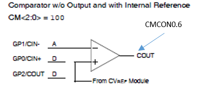

CMCON0 Register:
bit 6 COUT: Comparator Output bit.
This is the logic bit output of the Comparator.
CM: Comparator Mode = 100
Attachment 7686
With this setup the comparator is comparing VIN- (CIN-/GP1) to VIN+ (which is not an external pin but it is "From CVREF Module", internal voltage reference)
So you need to look at the description of COUT in the CMCON0 register listed below AND you need to look at Table 8-1 in the DS.
This will help you work out what value CMCON0.6 will be based upon a given input on GP1.
Take note that CINV is a configuration bit within the CMCON0 register that determines the logic polarity of COUT.
COUT: Possible values
When CINV = 0:
1 = VIN+ > VIN-
0 = VIN+ < VIN
When CINV = 1:
1 = VIN+ < VIN-
0 = VIN+ > VIN
Brilliant! Thanks for the info again your the best! I should be able to get this working how I want it to now, then & only then will I move onto interupt with it.

ANSEL = %00000010 'pin 6 analog
CMCON0 = %00000100 'comparator mode
VRCON = %10101000 'voltage reference
TRISIO = %00000010 'pin 6 input
ON INTERRUPT GOTO int1 'interrupt handler is int1
INTCON = %11001000 'enable GIE and GPIE; clear GPIF
PIE1 = %00001000 'enable comparator interrupt
POT1 VAR CMCON0.6 'read potentiometer

Rob,
Looks like you got it working.:)
One little thing though.
The Pause command is based upon the "DEFINE OSC" value to calculate the pause interval correctly.
It is a good practice to have your "DEFINE OSC" statement up top in the source code before you use any time sensitive commands such as "Pause x".
The way you have your program setup the following occurs, which I presume you have seen in practice on your physical system.
The LED on GP2(pin5) will stay LOW (OFF) while the voltage input on GP1(pin6) is above your reference voltage.
The LED GP2(pin5) will blink in 1sec intervals while the voltage input on GP1(pin6) is below your reference voltage.
This works fine on my simulator.
Good job!
It looks like you're ready for a "nap" now.:D
