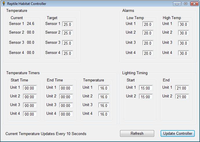

Hi Malcolm,
You can get that error message when you've missed a comma somewhere in the HSERIN command, look carefully and I think you'll find it.
Anyway, I took a stab at it here and I think the following should do it:It seems to work, I wrote up a bit of code to re-send all the variable back to PC and it looks like in the attached screenshot. Note that I'm only sending the "S" and I'm not waiting for that final "Q" in your datastream.Code:'-------------------------------------------------------------------------------

PS. Here's the code I used to send everything back to the terminal, might be good for further debugging:Code:HSEROUT ["-------------------------------",10]
For Counter = 0 to 3
HSEROUT ["Normtemp ", #Counter, " : ", DEC3 Normtemp[counter],10]
HSEROUT ["AlarmHigh ",#Counter, " : ", Dec3 AlarmHigh[Counter],10]
HSEROUT ["AlarmLow ",#Counter, " : ", Dec3 AlarmLow[Counter],10]
HSEROUT ["Start ",#Counter, " : ", Dec2 StartHour[Counter],":", DEC2 StartMin,10]
HSEROUT ["Stop ",#Counter, " : ", Dec2 StopHour[Counter],":", DEC2 StopMin,10]
HSEROUT ["Droptemp ",#Counter," : ", DEC3 Droptemp[counter],10]
HSEROUT ["Light set ",#Counter, " : ", DEC2 LightSetHr, ":", Dec2 LightsetMn,10]
Next
HSEROUT ["T H A T ' S I T M A L C O L M",10,10]
