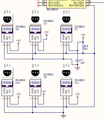

hi all,
i would like to make the circuit for the thermostat. could you please upload the circuit schematic? thanks a lot for your help.
Dear all,
sorry for asking you for the schematic, i did it from the code but i need your advice according to the second sensor please.
could you please help me out to finish the schematic?
thanks.
i have been trying to simulate the circuit on the proteus and also trying to make it work on the test board.
On the simulation i have some result but on the test board i dont get anything on the lcd.
Unfortunately with the code from Elektor i get some results on the lcd on the test board. But very wrong result like 234 oC.
Could someone upload the hex file from Mr. Fratello's #35? Could anyone made it work?
The second sensor (and the third, forth, fifth, etc, etc.) simply goes in parallel with the first... see example below.Quote:
Attachment 6011
The PIC's job is to address each individual sensor to read its value. That is how the One-Wire bus works. Each sensor has an address and will only respond to it's address.
hello,
thanks for the answer. i use the DS18B20, so i dont need to do any modification.
The problem is that i cannot see anything on the display. It looks like something is really wrong inside the code.
I think that i make the mistake on the code or the circuit above.
1) does this schematic corresponds to the code? (i need to put one more sensor)
2) do i need to do anything inside the code
for example in the following lines do i need to chose one of these?
;DS18B20_9bit CON %00011111 ; 93.75ms, 0.5°C
;DS18B20_10bit CON %00111111 ; 187.5ms, 0.25°C
;DS18B20_11bit CON %01011111 ; 375ms, 0.125°C
;DS18B20_12bit CON %01111111 ; 750ms, 0.0625°C (default)
DS18B20_1_12bit CON %01111111 ; 750ms, 0.0625°C
;DS18B20_2_12bit CON %01111111 ; 750ms, 0.0625°C
But still i dont see anything on my lcd.
To be more specific,
as i understand i need to find the unique ID from each sensor and then modify it on the code.
First i need to solve an other problem, what about i dont see anything on the display?
Shouldnt i see some 'no sensor' or like that at least?

thanks a lot for your help! am i doing something wrong with the schematic? Do i need anything else?
The code from the elektor works, but i dont have the ds1820. And it is on the screen xxx.xx
But i dont understand why it does not work with your code.
First you need to prove the pic is running. There are no caps shown in above schematic at the xtal, do you have caps on it? Have you made a led blink? Did you try internal osc?
From the quick skim I did on this thread, it seems I have read several posts claiming the code works. Time to look at your hardware.
ok i will try later this afternoon to blink an led.
Do i need capacitors for the ceramic 4 mhz resonator? I have also used a ceramic with 2 legs resonator at 4 mhz.
In any case i will try to blink an led.
As i mentioned on my previous posts, i have tried also the code from elektor, and works. (i just dont have the right sensor DS1820 which is very old and i dont get the right results. but i have something in the screen at least.
With the code from Mr. Fratello, i dont have anything on the screen. That mean that there is something wrong, either with the hardware or software.
Thank a lot again for your help.
