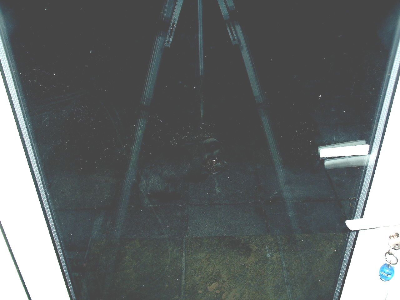

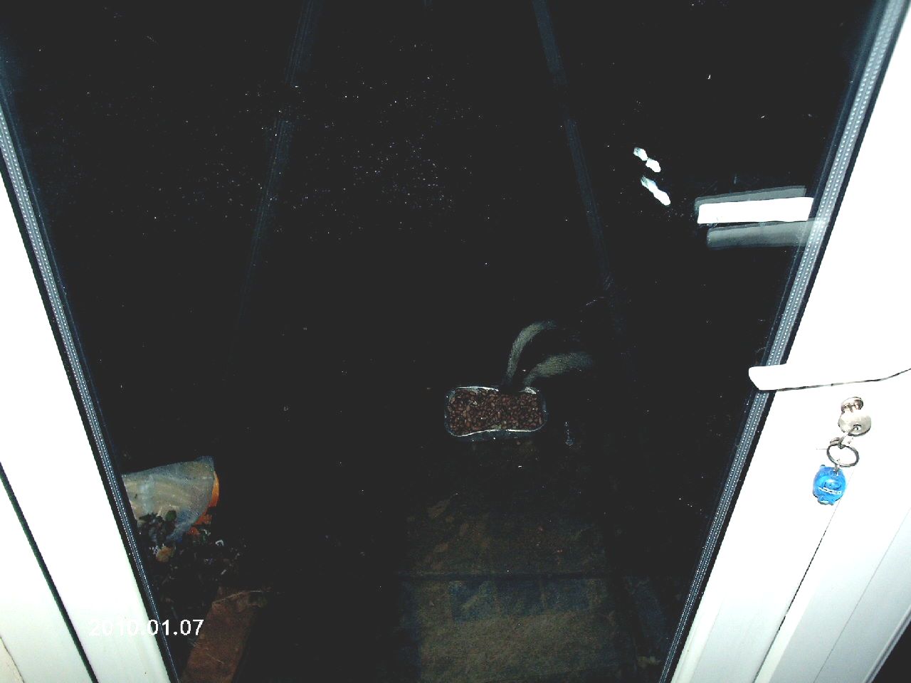

Well here are the results of night one.
I can't really believe it but there he is Mr Badger (or maybe that should be Mrs B not sure) oh and a mystery guest too.
When I woke up this morning there were 48 pictures taken (48!) so the device worked a treat.
Tonight, I'm putting the peanut container on the step right outside the doorway, if he turns up I should get a much clearer photo.
An amazing result for night one though.

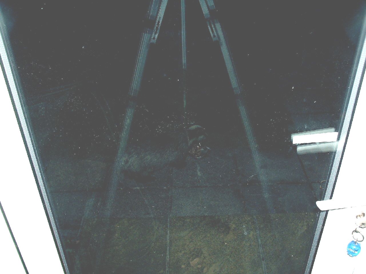

Last nights picture:)
Please note the cunningly hidden PIR detector inside the old Cornflakes packet itself inside a polythene bag (bottom LHS).

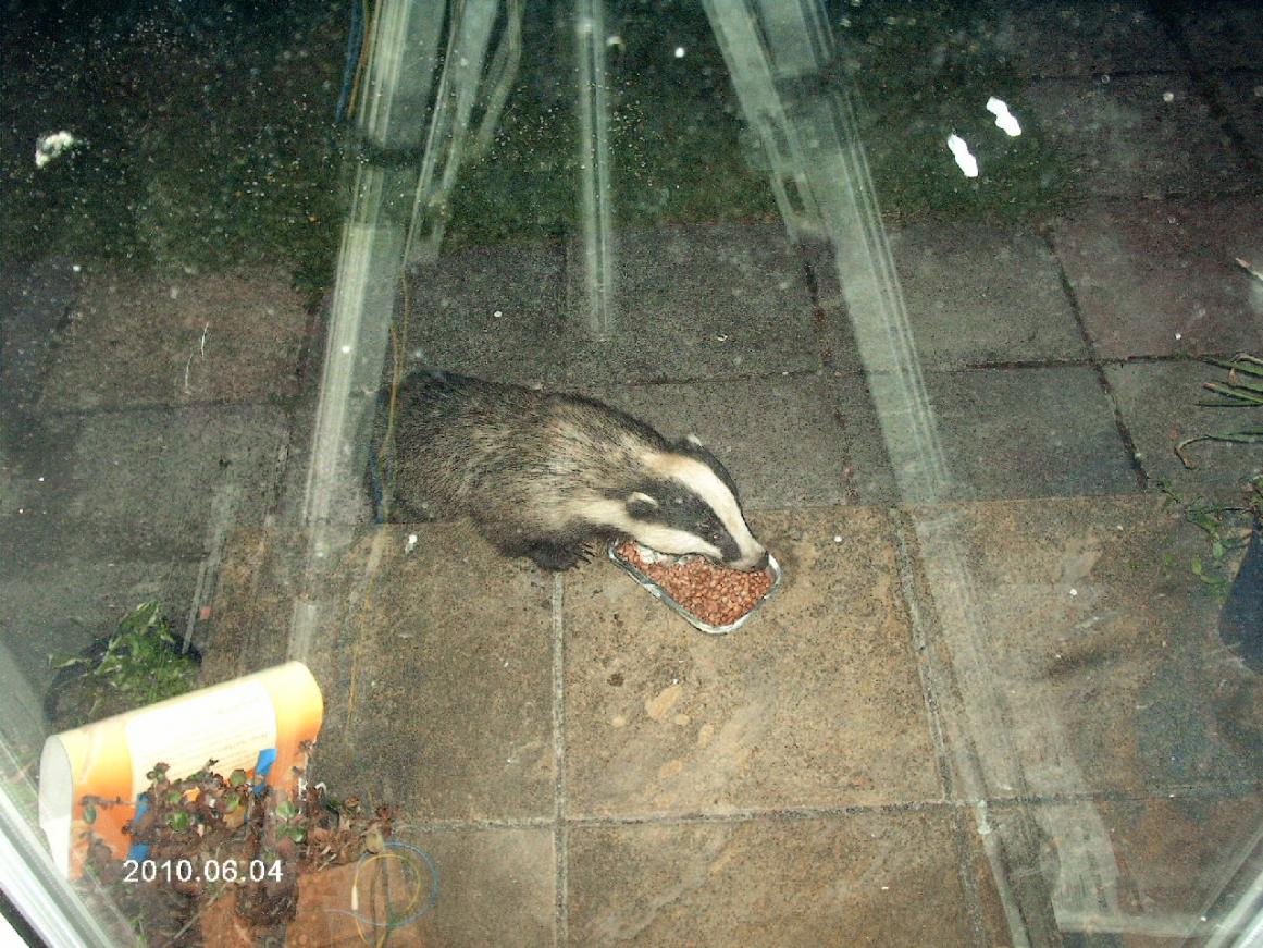

Last nights pictures, the best so far I think:)
Those are great.
How did you do the lighting?
Hi mackrackit,
The lighting was the camera flash (I'm still looking into IR_LED's) But I placed some diffuse material over the flash lens (Ok I'll fess up, it was a small piece cut from the plastic bag inside a cornflakes packet). It seemed to work though, still some flash flare but not bad.
