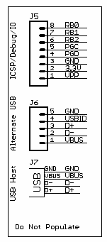

scalerobotics, I thought that you suggested that J5 will work with the PICKIT USB connector.
I can not find J5 on the board. I can find J6 but not J5. I downloaded the .pdf file which is a picture of the board. It is sooo messy that I can not find J5 on it either.
HELP.....
KEn
J5 is the tail end of the board...

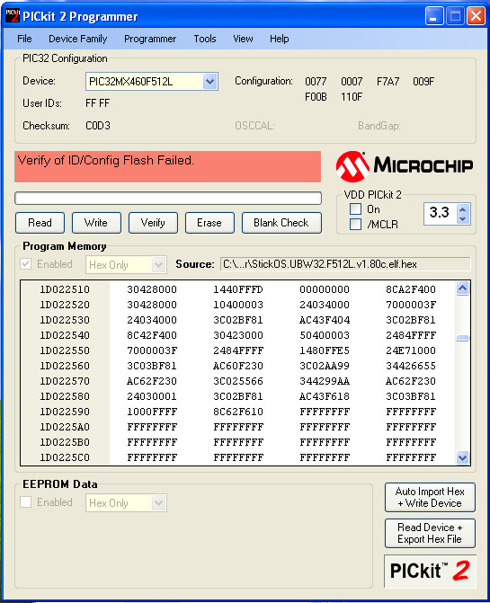

That came after I hit the WRITE button. I was asking it to load that .hex file. It seems to load mostly correctly, but comes up with that funny error.
Ken
Are you sure your pickit is plugged in right because it should be verifying the I'd. Mine was verifying air, so that's why mine has that waring
The BIT Whacker schematic shows the connections from the 4 pin USB port [UBUS and USBID] to be different than the connections from 5 pins into J6 [PGB,PGC and RB2]. When "Writing Device PROGRAM FLASH and BOOT FLASH" it just sits there with the little red BUSY light flashing on the PICkit2 connector. Forever.....
I tried to use the USB port. Both to load the .hex file and to communicate. No success of any kind. Notta.
At least PICkit2 through J6 illuminates the blue POWER LED.

I tried loading HELLO WORLD.hex. No luck at all. Same error message but no success loading EEPROM.

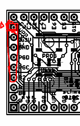

I think you are sticking your Pickit in the wrong port.
I know they are not spelled out as nice as the schematic, but, your pickit goes on J5 (same one I mentioned earlier). Later, after programming, you can try to plug in the usb host cable. The other 5 pin spots on the board are for USB.
Attachment 4833
Here is where it goes. Should be a lot happier now...:
