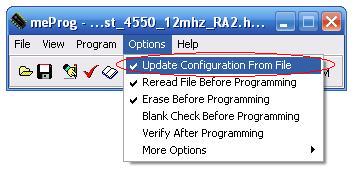

The programmer configuration is:
PLL prescaler "/3 (12MHz)"
System Clock Postscaler "96MHz PLL/2"
USB Clock "HSPLL"
and in the beginning of the generated basic code there are
DEFINE OSC 48
DEFINE LOADER_USED 1
