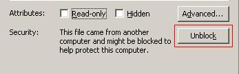

The files which would not compile (16Fs) were copied from a network computer so they were being blocked by the Windows Firewall. When I was trying to erase all the code and save it using the save as dialogue the same attributes were being passed off being in the same folder. (I guess) Thus the simplest code ever also would not compile. The 18Fs which were compiling were on the local system thus no issues. I thought it must be something with the PBP lib file. But it was all due to the windows firewall.
Solution:
Attachment 1952
Right click on the file and hit properties and click unblock, ok. This should let PBPW access it without any trouble.
