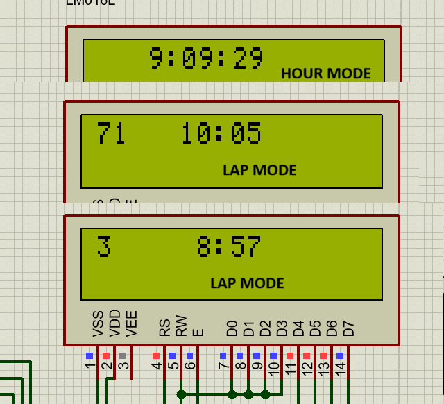

I assume you are trying to achieve something like this where the minutes/seconds remain at a fixed location regardless of the other formatted field widths in either lap mode or not
Attachment 10044
its quite simple if you use a frame buffer for the lcd line and designate a frame address for each element to show, the fixed elements [that never change] can be set once off at code startup. you then just need to update each changeable element according to the rules/mode that currently apply when necessary. the display is updated from the buffer when necessary. its not only much faster it uses considerably less code space

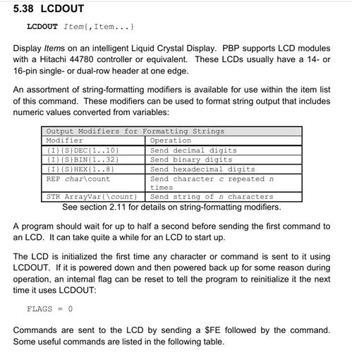

I should have first, but I totally forgot to give a look to the PBP manual:
Attachment 10046
