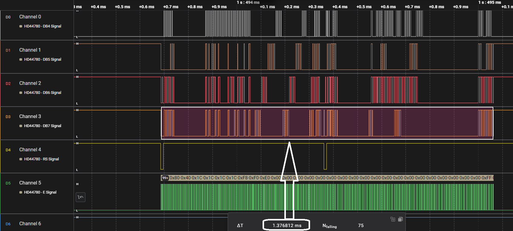

why 160 bytes ? to employ the entire screen area you need 200 bytes in graphics mode
Quote:
Will PBPs arraywrite/arrayread operations provide enough speed at 18F running at 64mhz
i cannot see anyway that arrayread or arraywrite would be useful in transferring a frame buffer to the display
the displays are very fast, pbp has no trouble uploading a full 200 byte frame to the display in 1.37mS using 4bit parallel interface with the standard built-in lcd routines
plenty fast enough
Attachment 10049
