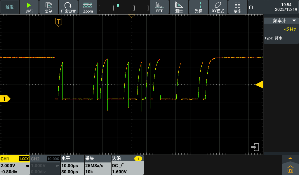

I decided to check the signals with scope, and they're heavily distorted. (image 1) I have 10K pull-up resistors on both SDA and SCL pin. So to test the issues, I've added this simple code:

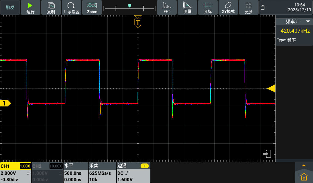

asda: 'small test for waveform shape
high SDA_PIN
pauseus 1
low SDA_PIN
pauseus 1
goto asda
When I run this code, the shape of the signal is perfect, as you can see from the 2nd image (and frequency is much higher, so definitely no capacitive loading issues). So what can be the reason I2CWRITE making so badly shaped signal?

Re: I2CWRITE/I2CREAD access hardware in the different way? (PCA9685 issues)
what pic chip ?
how is pc9685 wired up [sketch]
i2c pins should not be set as outputs
In your "working" example 2 you're actively driving the pins high and low.
I2C is an open-drain/collector bus where the high level speed is determined in part by the pullup values.
To reduce the rise time, lower the values to 4.7K or thereabouts
Chip is 18F45K80. I changed pull-up values to 5.1K, not much difference in shape of signals, but at least now it works.
So in case of I2CWRITE, pins should be configured as input?
You should probably leave them as inputs.
The I2C commands will change them from inputs to outputs as required to simulate an open-collector signal (high=input, low=output 0).
It would probably work as outputs too, but there would be a period of time where the lines were being actively driven until the first I2C command, so better to have them as inputs.
