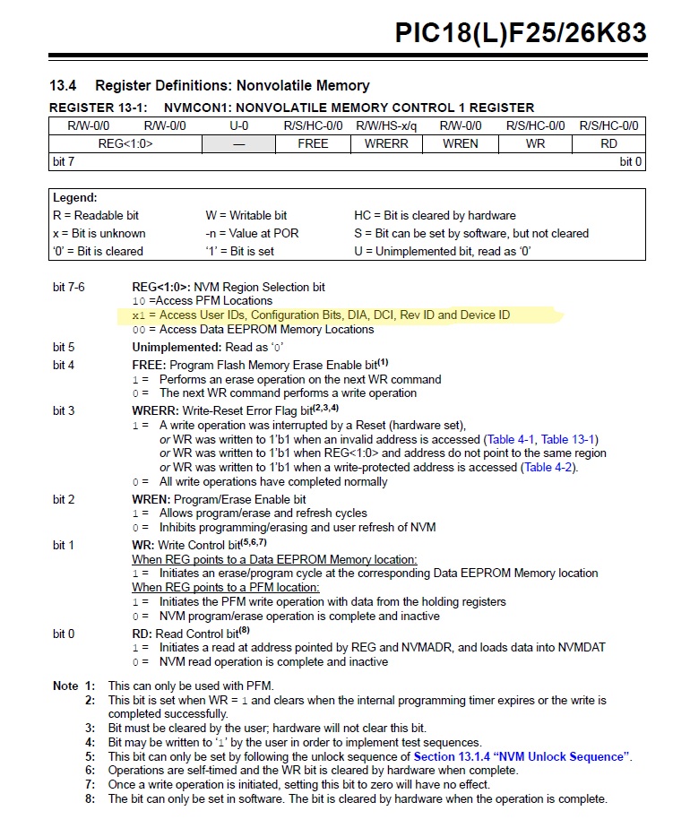

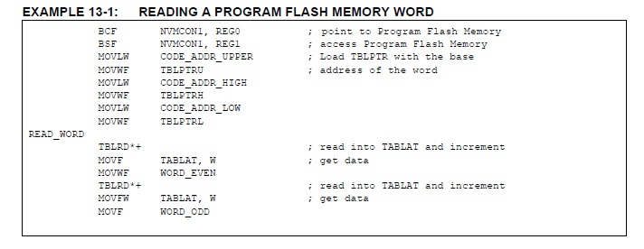

it looks to be pretty much the same as for any of the non volatile memory for that chip
Attachment 10004
once region is set
Attachment 10005
Re: Gathering chip temperature from PIC18F26K83
Okay, thanks Richard. I was really hoping to avoid assembly, but it is what it is.
Thanks again for that Richard. I'm discovering the only assembly instruction I really need as an assembly call is the table read command. Everything else (reading & writing to registers) can be done in Pic Basic.
