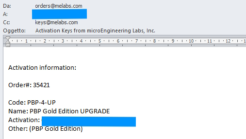

Re: Starting with PBP: how to restart with PBP today
Quote:
Originally Posted by
rsocor01
Attachment 9956
this is the email with the activation for "PBP-4-UP", received in 2011 with the activation key...

Maybe this was internal name of thew updates.
But the known version were the ones posted by rsocor01

four work station license ? pbp ver unknown
If you bought it in 2011, it is probably version Pbp 3.0.1 the gold edition. See the version history link I posted above. The PBP-4 is probably some code you needed to enter when activating it.

Ioannis is right on this one ...
dated 05/08/2011
Quote:
Activation information:
Order#: 3xxx2
Code:PBP-4-UP
Name: PBP Gold Edition UPGRADE
Activation: xxxxxxxxxxxx
Other: (PBP Gold)
Activation Serial Number for PICBASIC PRO Compiler:

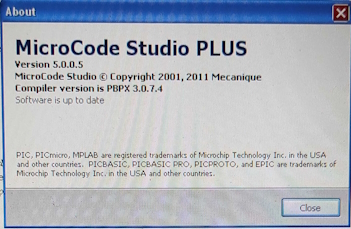

Attachment 9959
Thanks to everyone for the help and I update the post:
I finally managed to repair Windows XP, blocked since 2016, containing PBP (PBPX 3.0. 7.4) and MicroCode Studio (MCS+ 5.0. 0.5), which now work perfectly.
Now I intend to install the entire environment (PBP, MCS, MPLAB) on the Notebook with Win 11 pro.
The internet functions work (tracert and ping), but of course Win XP does not allow navigation.
What is now the procedure to recover the license installed on XP?
Do I simply have to uninstall the 2 applications with the internet connected?

In your PBP installation folder you should have program called meLabsReg.exe and document called melabsreg.pdf - check those out. But again, the license allows you to have PBP activated on up to 3 machines so unless you already have it on 3 machines I'd get it working on the new machine first and THEN try to deactivate on the old one.
HenrikOlsson
AND ...
Once you have launched meLabsReg.exe in the old Win XPmachine ... you will see your activation Key number !!! ;)
just copy and paste it into your Win11 installation ( need to run meLabsReg.exe on the W11 computer )

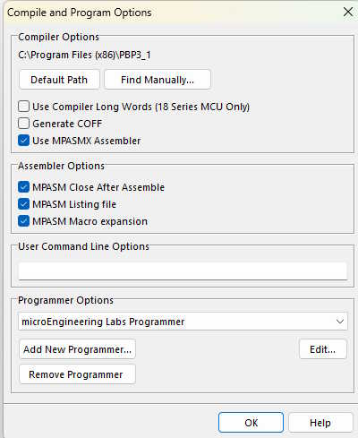

After the MCSP installation error, I am stuck with MicroCode Studio version 5.0.0.5
If it is not essential to use the Plus version, I will follow your advice.
I have installed MPLAB X IDE v5.35
And I have the configuration
Attachment 9961
Can I start playing? :)
Thanks to everyone for the valuable advice.

Looks like you're good to go!
