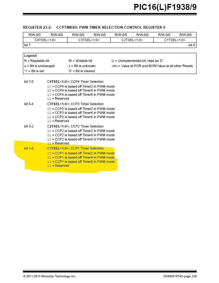

For 16F1939 default timer for HPWM1 is Timer1,
Incorrect , timer1 is not an option for hpwm1 ever
timer2 is the default for ccp1 on 16F1939
see CCPTMRS0: PWM TIMER SELECTION CONTROL REGISTER
Attachment 9905
