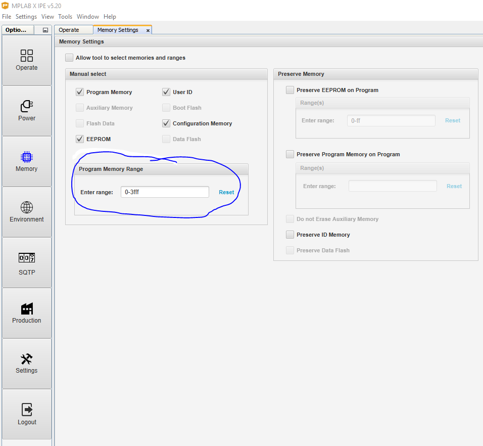

And what software to run the programmer??
If you're using MPLAB X IPE you can select View->Advanced Mode->Memory Settings and then uncheck "Allow tool to select memories and ranges" and finally enter the range you want to program:
Attachment 9874

The stand alone apps do not support specific range. They program all the memory range.
