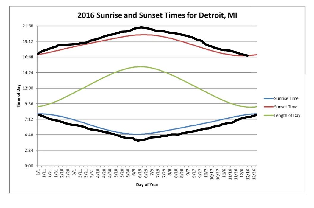

Isn't the changing sunrise and sunset times mostly a sine wave function, with the 2 times opposite of each other. Basic has a sin function. and the sin values would synchronize with the date and the sin multiplier for minutes change/day value would depend on the latitude of the location of the clock....

Just a thought: from what I understand from Amgen's and Henrik's suggestions, is that the sunrise and sunset would be roughtly linearly calculable.
Is it so?

Re: Calculating Sunrise and Sunset 2
black is my attempt at a straight line.... follows actual times fairly close enough to actual exact times. It is just adding and subtracting X minutes each day for 1/2 a year then switching the add-subtract.Attachment 9802
