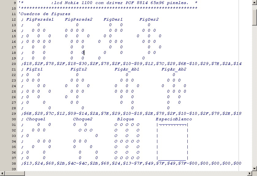

'Cuadros de figuras
; FigParada1 FigParada2 FigDer1 FigDer2
; 0 0 0 0 0
; 0 0 0 0 0 0 0 0 0 0 0 0 0
; 0 0 0 0 0 0 0 0 0 0 0 0 0 0 0
; 0 0 0 0 0 0 0 0
; 0 0 0 0 0 0 0 0
; 0 0 0 0 0 0
;$18,$2F,$78,$2F,$18-$30,$2F,$78,$2F,$10-$09,$12,$7C,$28,$6E-$10,$29,$7E,$2A,$14
; FigIz1 FigIz2 FigAr_Ab1 FigAr_Ab2
; 0 0 0 0 0
; 0 0 0 0 0 0 0 0
; 0 0 0 0 0 0 0 0
; 0 0 0 0
;$6E,$28,$7C,$12,$09-$14,$2A,$7E,$29,$10-$18,$2E,$78,$2F,$10-$10,$2F,$78,$2E,$18

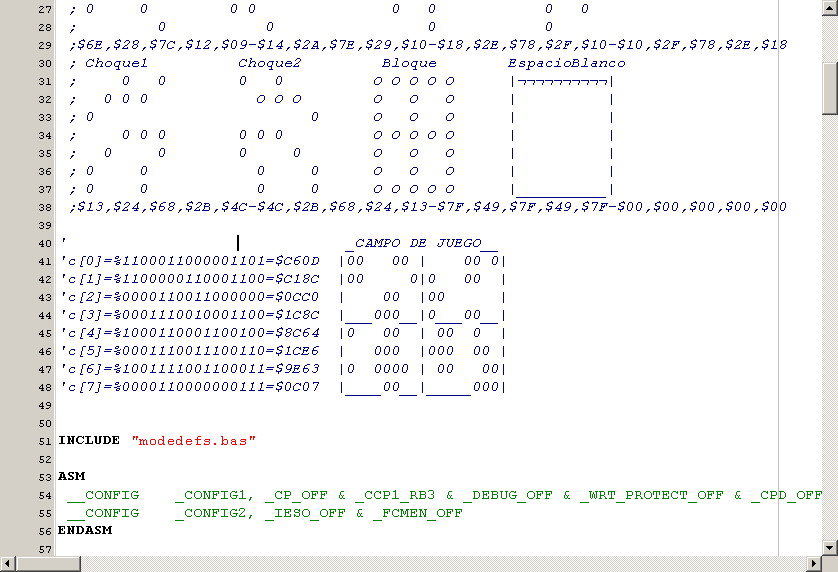

; Choque1 Choque2 Bloque EspacioBlanco
; 0 0 0 0 O O O O O |¬¬¬¬¬¬¬¬¬¬|
; 0 0 0 O O O O O O | |
; 0 0 O O O | |
; 0 0 0 0 0 0 O O O O O | |
; 0 0 0 0 O O O | |
; 0 0 0 0 O O O | |
; 0 0 0 0 O O O O O |__________|
;$13,$24,$68,$2B,$4C-$4C,$2B,$68,$24,$13-$7F,$49,$7F,$49,$7F-$00,$00,$00,$00,$00
' _CAMPO DE JUEGO__
'c[0]=%1100011000001101=$C60D |00 00 | 00 0|
'c[1]=%1100000110001100=$C18C |00 0|0 00 |
'c[2]=%0000110011000000=$0CC0 | 00 |00 |
'c[3]=%0001110010001100=$1C8C |___000__|0___00__|
'c[4]=%1000110001100100=$8C64 |0 00 | 00 0 |
'c[5]=%0001110011100110=$1CE6 | 000 |000 00 |
'c[6]=%1001111001100011=$9E63 |0 0000 | 00 00|
'c[7]=%0000110000000111=$0C07 |____00__|_____000|

2 Attachment(s)
Re: programming jumping game
this are a figs of a program Juego Bloques
Attachment 6277Attachment 6278

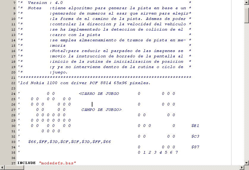

Attachment 6279
'* Name : AUTOS2 .BAS *
'* Author : Leonardo Castillo *
'* Notice : Copyright (c) 2011 [select VIEW...EDITOR OPTIONS] *
'* : All Rights Reserved *
'* Date : 17/04/2011 *
'* Version : 4.0 *
'* Notes :tiene algoritmo para generar la pista en base a un *
'* :generador de numeros al asar que sirven para elegir*
'* :la forma de el camino de la pista. Ademas de poder *
'* :controlar la direccion y la velocidad del vehiculo *
'* :se ha implementado la deteccion de colicion de el *
'* :carro con la pista *
'* :se emplea almacenamiento de tramos de pista en me- *
'* :moria *
'* :Nota2:para reducir el parpadeo de las imagenes se *
'* :movio la instruccion de borrado de la pantalla al *
'* :inicio de la rutina de inicializacion de posicion *
'* :y ya no interviene dentro de la rutina o ciclo de *
'* :juego.
'lcd Nokia 1100 con driver PCF 8814 65x96 pixeles.
' 0 0 <CARRO DE JUEGO 0 0 0 0
' 0 0 0 0 0 0
' 0 0 0 0 0 0 0 0 0 0
' 0 0 0 0 CAMPO DE JUEGO>
' 0 0 0 0 0 0 0 0
' 0 0 0 0 0 0 0 0 0 0 $E1
' 0 0 0 0
' 0 0 0 0 $C3
' $66,$FF,$3D,$CF,$CF,$3D,$FF,$66
' 0 0 0 0 $87
' 0 1 2 3 4 5 6 7
