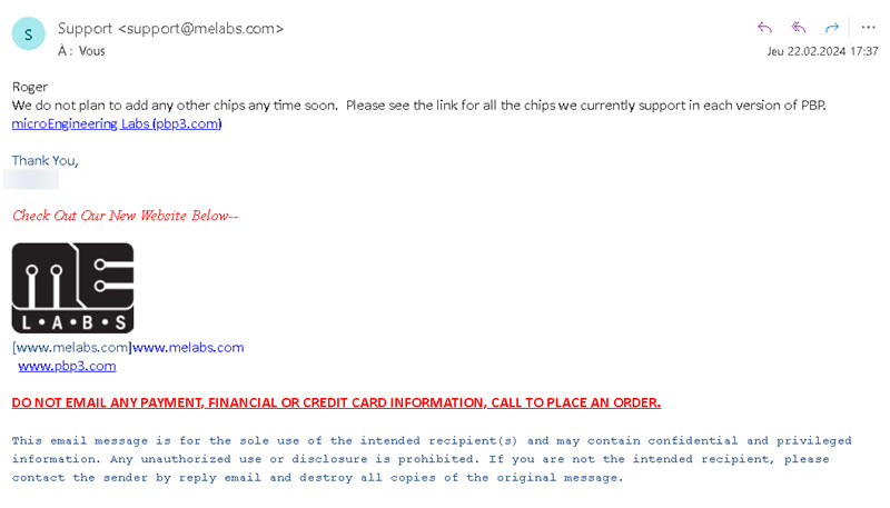

Latest PICs - how to program them?
So then,
Since PBP doesn't seem to go on for newer PICs,
Attachment 9647
...what are the options?
Is there any "new" BASIC compiler out there that will take over from PBP?
