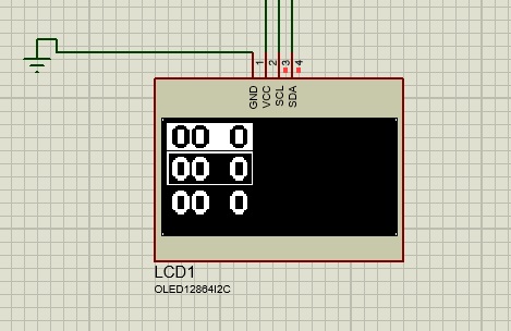

Re: SSD1306 Inverse screen example?
to invert entire display
SSDC $A7
to restore it USE
SSDC $A6
I was thinking
Attachment 9567
