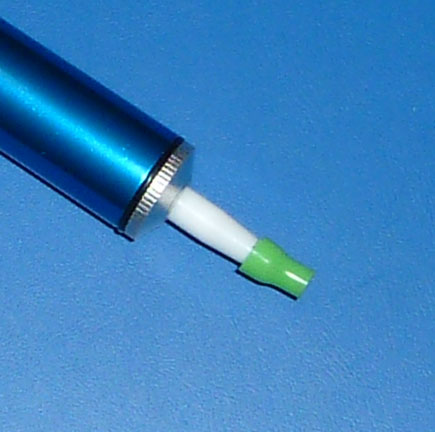

I just checked to see if there's other "blue models", turns out there is. I had this one; worked ok, but that tip melts slowly and becomes ineffective as it shortens.
https://www.stewmac.com/luthier-tool...solder-sucker/
That silver one though; it's freaking awesome. Be careful not to lose that flexible hose; it's very important to get maximum effect.

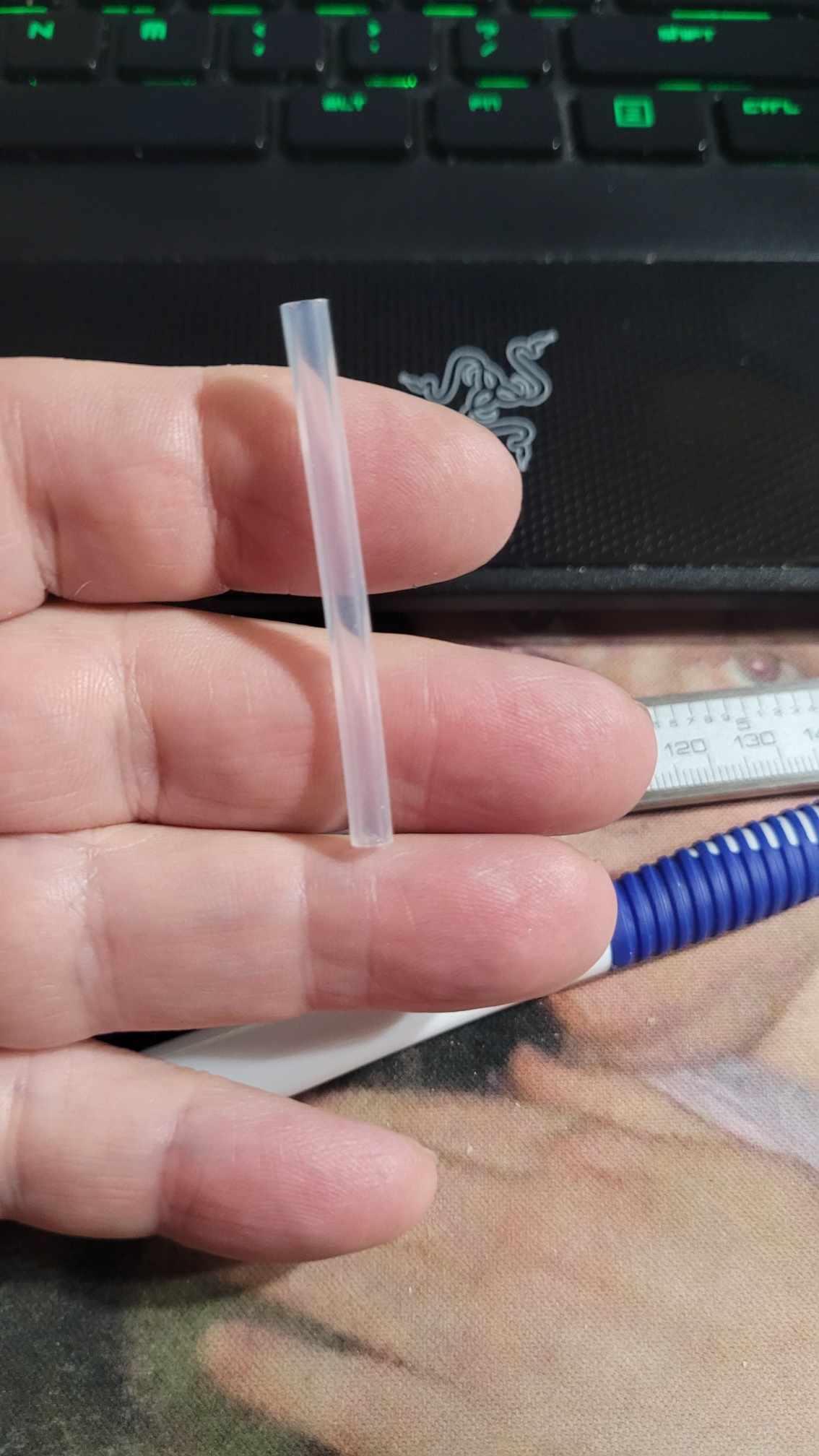

Careful when you open the package. Mine came with a longer tube for repairs.
Attachment 9565
There are replacement silicon tubes available. Not the teflon rubbish...
I've just tried a bit of model aircraft silicone fuel pipe on my blue solder sucker and it now works a lot better. The original teflon tube needs shortening a bit so the nozzle / fuel tube can be cleared of solder. Clear silicone fuel tube would be better.
Attachment 9568
That's a great idea!
After cleaning the tube, what do you use for lubrication?
Never needed to lubricated it. Oil will clog up the bits of solder instead of them being ejected.
